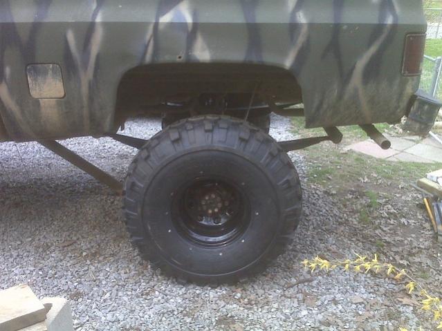

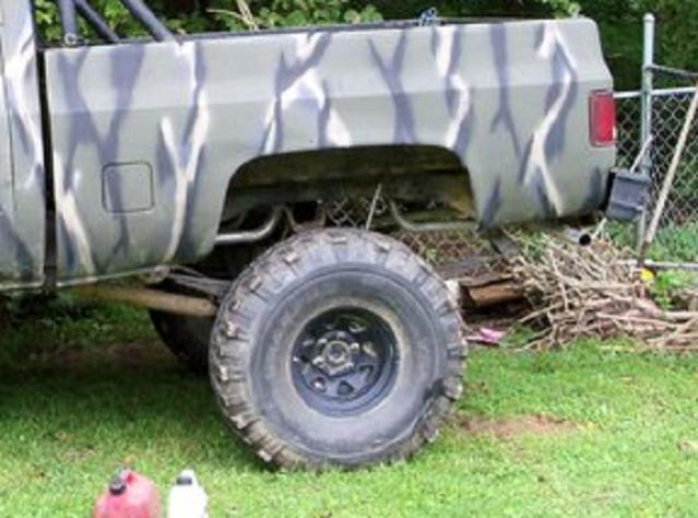

Pay attention to year range and net lift when looking at those, and then realize the shackle flip kit is the best way to go. You may need a pair of Zero Rate Add-A-Leafs to relocate the axle back 1" to 1-1/2" to recenter it in the wheel well after the shackle flip. You can see the difference the Zero Rates make here:
Before:
attachment.php
After:
attachment.php
Hard to believe 1.5" can make that much of a difference but it does. Those are stock height 56" 3/4 ton rear springs by the way on my K10, a little more flexy, softer riding. I needed 6" lift so I have a 2" block on there as well to fit the 38s.
