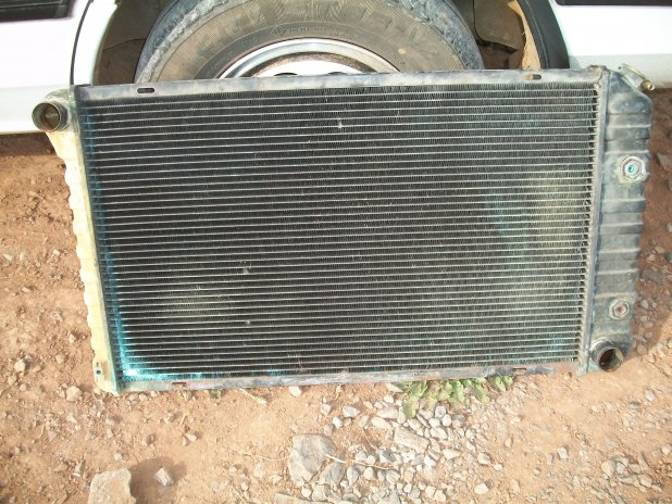

I need to replace the radiator in my truck, it's a 78 K20, with a 350, 4 speed manual transmission, nothing fancy, does not have ac, only power steering.

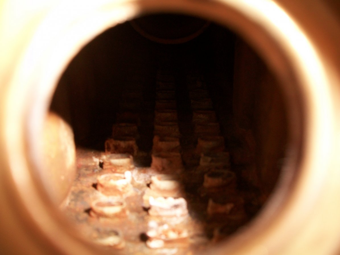

the radiator I took out is an after market, the guy at the radiator shop called it a CU161, it's aluminum with copper end tanks. (see pictures)
I was told it would cost about $365 to rebuild it, and the guy didn't think it was worth it as it's already been rebuilt or fixed before and would need to be re-cored. also looking at the picture, it looks to me like my old radiator is a 3 row? am I correct?

I didn't notice that vista pro radiator, so is that 3 row going to be better than an all aluminum 2 row?
from what you just showed me, it kinda looks like I should go with the vista pro 438161

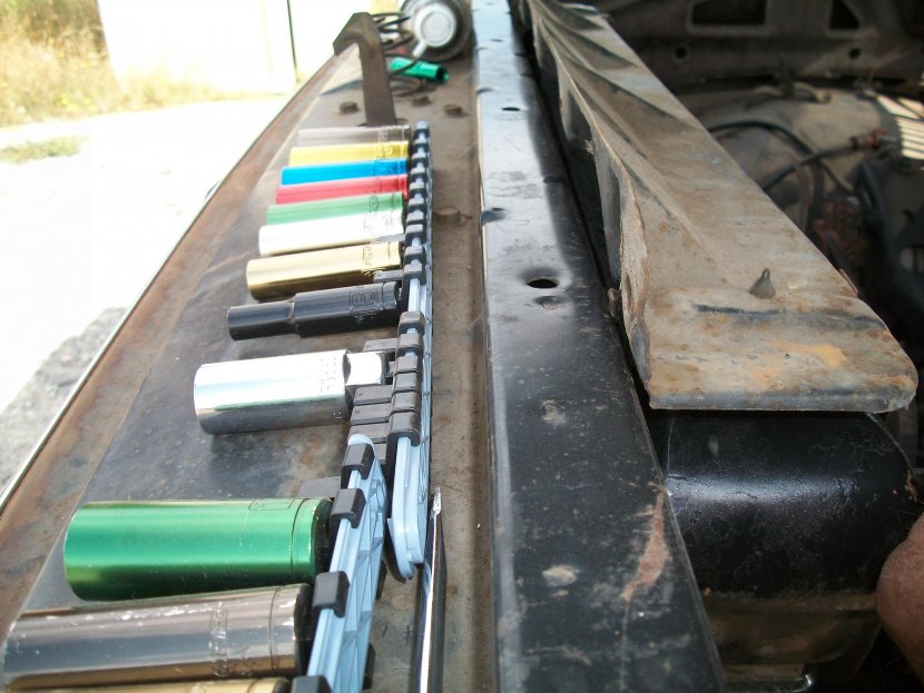

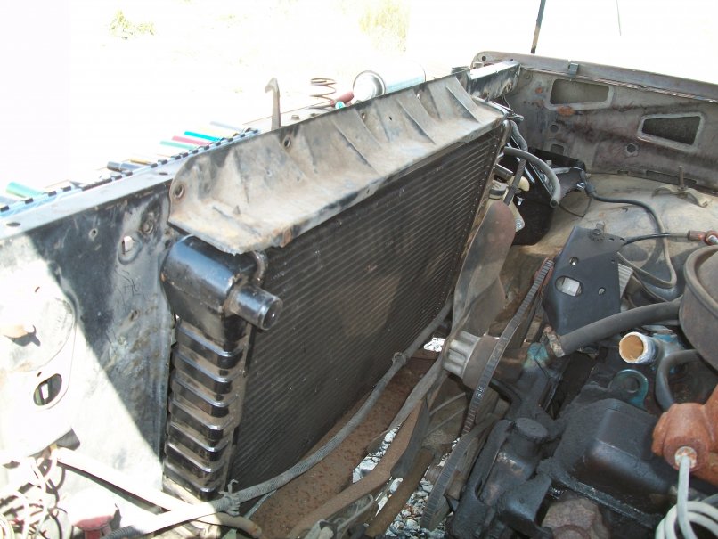

using the picture you posted with the red lines, mine comes out to be about 18.5 inches tall, but I have two radiators here, one of them being a 4 row supposedly out of a 78 blazer, and it's about 2 inches taller then mine and won't fit my brackets - see pictures

The HD radiators are about 2 inches higher and use a special pair of clamps to accomodate that extra height. I don't know how they look on the 70's trucks but on a 81-87 the clamps look like this:
The two bolts screw into the top of the radiator support and the shroud is attached at the single screw in the front.
On your radiator support, I don't see the holes and weld nuts that would be used with these brackets. They must use the same holes - the ones on the vertical surface - and gooseneck up somehow. They sell HD radiators for your truck so there must be some way to clamp the top.
You might have to go to a junkyard and look/pull the parts you need. The shroud may be different as well.
It might be easier to look for a standard duty radiator.
