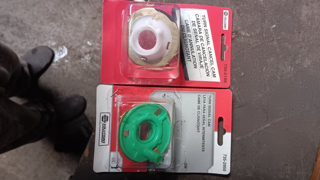

Dont know if this would cause this, but Did you replace canceling cam? There's 2 different ones.
If the wrong one was installed, the lock plate wouldn't have fit. I found that one out the hard way, lol

When I initially took it apart there was no snap ring or cancel cam..the steering gap was normal. Since I've replaced those parts now gives me the large gap. With steering wheel off I can move the steering shaft in and out about a .25in.
