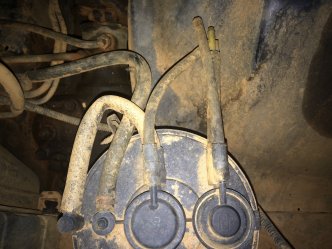

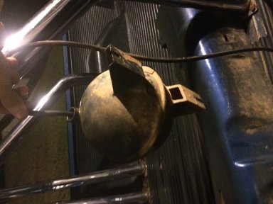

Alrighty then. So I has gots some questions that need some answerings if y'all can help. On mobile, I can only post one picture at a time for whatever reason so bear with me. Down here in Georgia, my 84 is considered to be a classic and therefore is exempt from emissions. I want to remove my charcoal canister from my engine bay seeing as how it's not needed. There is only one line hooked up which attaches to the hard line going back to the tank and I believe it is for the gas vapor so that it can be reused, right? I've been reading some of the forums on here and it says that I don't need that so long as the vapor can escape through the gas cap but only if it's a venting cap, right?

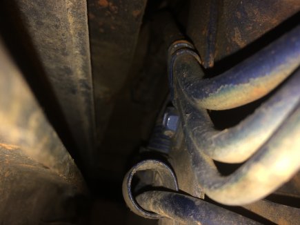

There are three hard lines that wind up going back to the tank that follow the frame. One is a fill? and the other two are send/recive? I think that's right. Anyways, they go above the tank to were I can't see which one is which. Idk which one to cut. Any help? I don't want to drop the tank at all btw. I don't think that I would have to do that though. These are the hard lines that disappear above the tank. Best pic I could get. Left, middle or right?

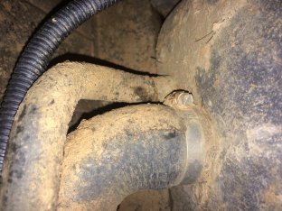

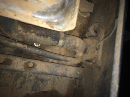

This is the line that parallels the gas fill line. Is this what allows the tank to vent vapors if need be? I remember reading something like that. If not, then what is it for? This pic is looking up at the fill line. Tank is on top. It just attaches right back into the tank so I'm stumped.

This is the line going right back into the tank.

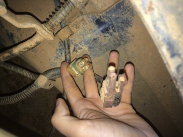

Real quick, truck has complete custom true dual exhaust. I'm assuming these are O2 sensor plugs? Only on drivers side.

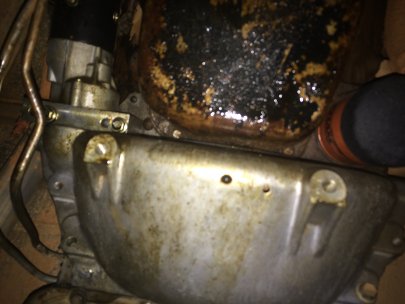

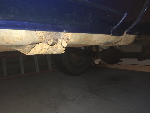

When I took the gas tank shroud off, I knew it was muddy but I expected it to be dry. Of course it wasn't, for quite some time it had been rusting through the bracket holding up the front of the tank. Yay, explosions are good right? So I'm in need of one. Any idea where to get one?

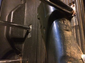

Gas tank shroud.

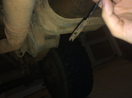

I have no brake lines. Emergency brakes I mean. Lol. 4inch lift installed and PO didn't think it was important to get new ones. Any extensions that I could get? No biggie for me though.

That is a vacuum reservoir. Should be connected to vacuum line with a tee that splits to run ac/heater. The plugs on the driver side look like for 700r4 transmission.

Found the support brackets for the gas tank.
You could put a filter on the EVAP line, vent from up top, and call it a day. You can also do a venting gas cap, and leave the line plugged like it is now, too.
One should be the EVAP, one should be the return, and one should be the supply. The fill one is fat. Which one are you trying to cut, the EVAP? You should follow it back from the canister if you can. Make sure you plug it real good if that's your plan.
