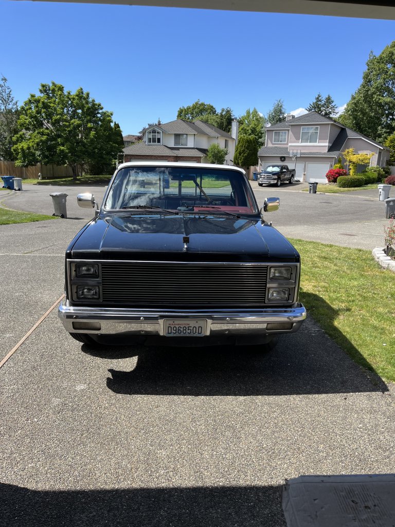

Yep - you are exactly right and I spoke too soon. The top secures nicely and the center screw on the bottom fits nicely, but there are two flanges on either side of the bottom are unsupported.
So you are saying that these attach to the splash guard and not the headlight bezels? Yes, I’d like to see photos if it is not too much trouble.
I’ll have to go back and see what a splash guard looks like and how much trouble that is going to be to source and replace. I may just let this one hang as is and then replace with a correct repro later - or maybe figure out a way to make brackets to secure them somehow. Thanks for posting.

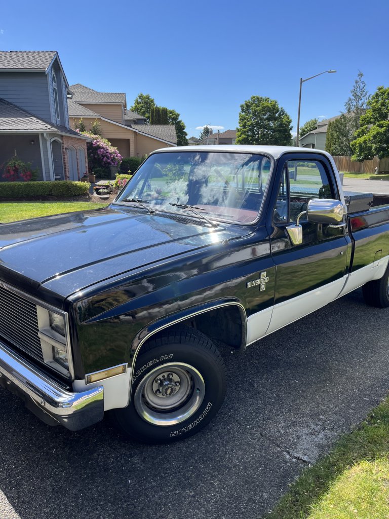

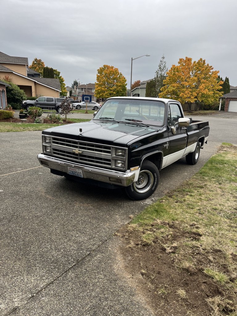

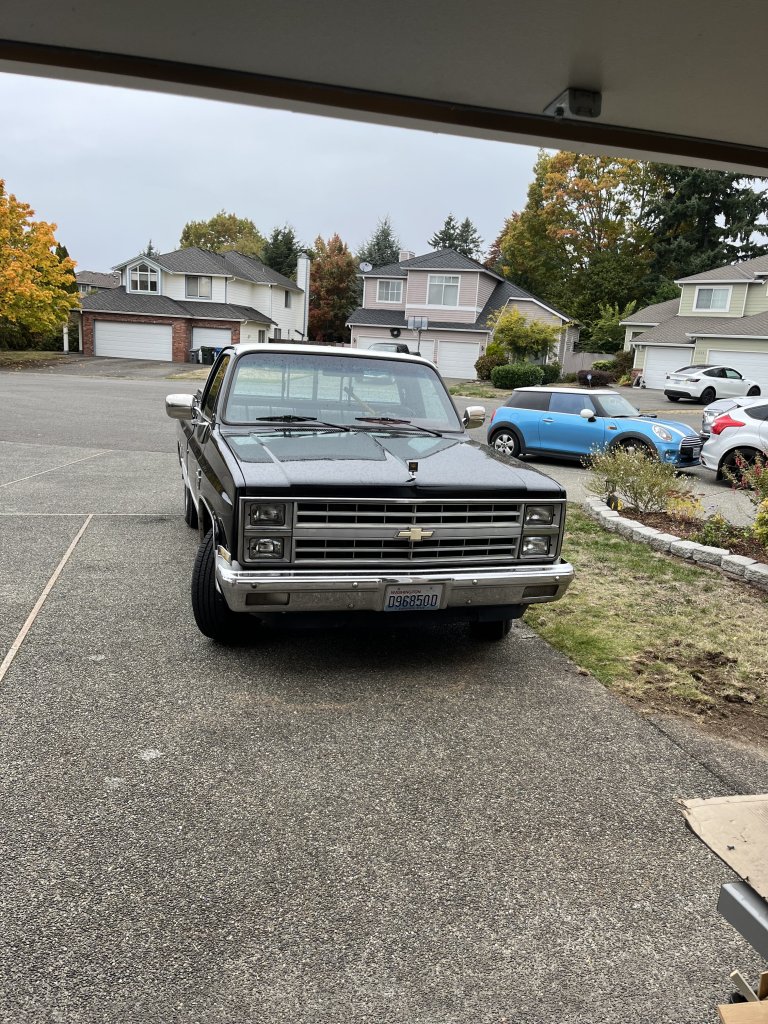

BTW - before and after pics. To my eye it is a huge improvement.

Could you not just drill a 1/8" hole and use a #8 trim screw to fasten? Or is there not enough flange there?
C10_Blackie
Jan 2, 2024
91
187
Seattle, WA
Rob
Ha. I had to to exactly that when the center flange snapped off, but no suitable place at the edges.
Maybe looking at it again after a good night’s sleep will shake something loose. I could probably make some supports out of stiff wire. It is very well secured at the top so it won’t need much - just enough to keep it in position.
