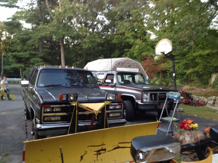

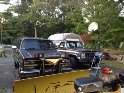

I have the rancho 9000 on my 87 it's the 89 I was mainly talking about I wanted to get Monroe sensa-tracks but they only come for single setup but I settled on Gabriel air shocks all around and setting up onboard air to keep the front end sitting up pretty even with the plow
