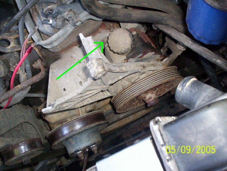

On TBI motors, the accessory cluster on the front of the motor, is that bracket all one piece? Maybe one on each side I guess. And where are the bolts located? Also looks like there is a bolt behind the PS pump that is impossible to access. Anybody take this off before?

I believe you have to detach the pump from it's bracket to get to that bolt. Don't necessarily have to take the pump off (although might not hurt anything) but at least detach it from it's bracket and lay it over to the side.
...and if I'm not mistaken that large bracket you asked about is all one piece.

SUmbitch!!!! That means the pully has to be pulled off the pump? STUPID!!!!!!

I've had my power steering pump off a couple of times and yes, there's a hidden bolt that's a bitch to find and yes, you need to yank the pulley off the pump. The upside is all auto parts either sell the puller or will let you borrow one for free if you buy your parts there.

:word: Autozone or O'Reilly has a rent-a-part deal where all you gotta do is lay down a refunded deposit that you'll get back once you return the tool. It's very nice!! :)
