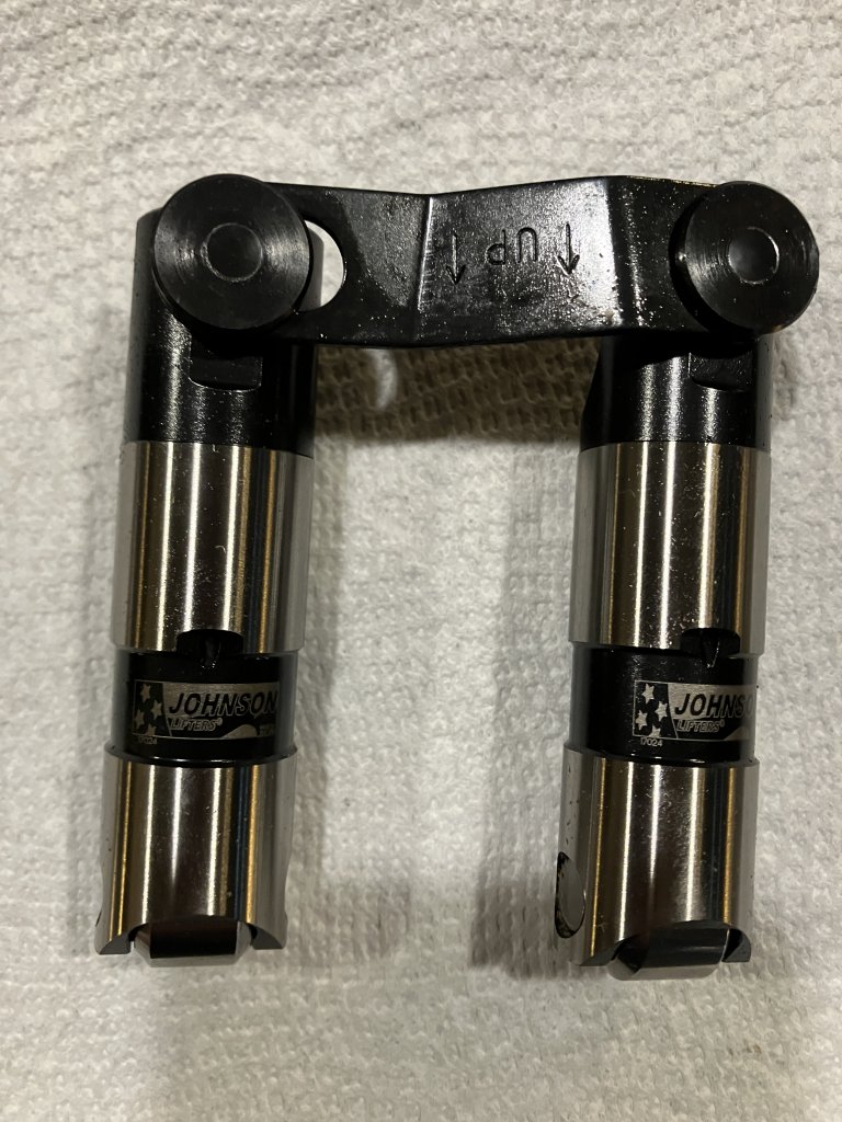

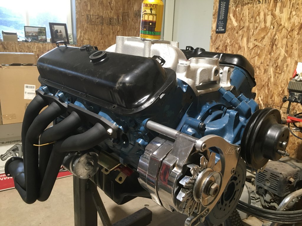

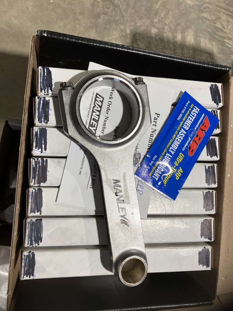

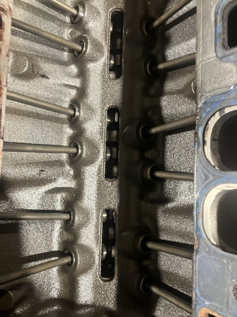

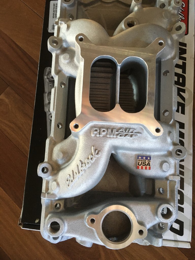

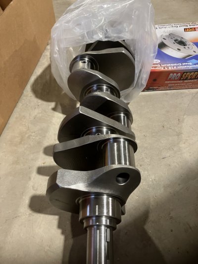

Lots of differences from my Mark lV, I think it will be easier seal with the flat surfaces, and FI is great. Interesting lifter locating for the roller lifters. Here is the old style lifters, I have since switched to Johnson. AFR heads on my build, and E-brock airgap, Wiseco pistons, Manley rods/W arp2000 bolts, Eagle crank, Studs on mains, Arp bolts for heads. Have about $9500 into it so far. Last two for reference, the original 454.

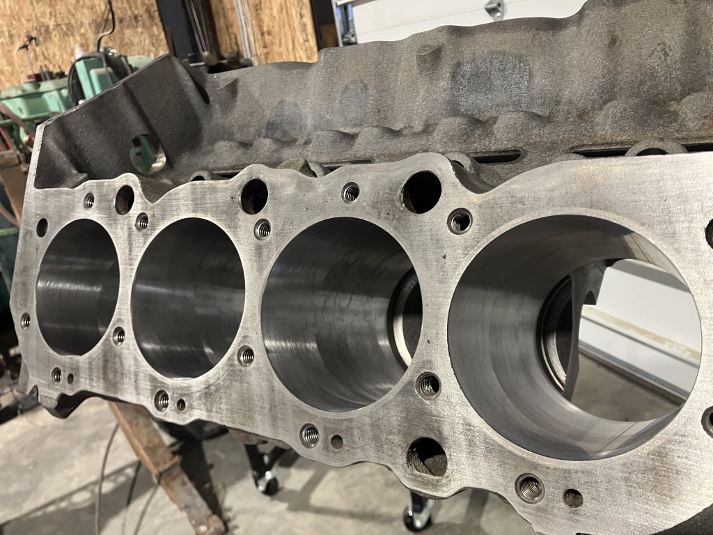

Original machined block was a complete, from a 1976 motorhome. What a difference in the 8.1/8.8!

Hey Perry, there are a few, I went to johnson direct, but they were out. They sent me to a guy on the east coast that is into building boat engines, and he had them in stock. go here: https://johnsonlifters.com/Products/Hydraulic-Roller-Lifters
Ph# 1-800-860-4233. Part # for mine were 2126bbr-16, so these were the .300 tall, reduced travel, .093 axis oiling, bbc tie bar set. Pre load is .035 +- .01 inch. $ alert, they are expensive, and in retrospect, I should have gone with solids.
