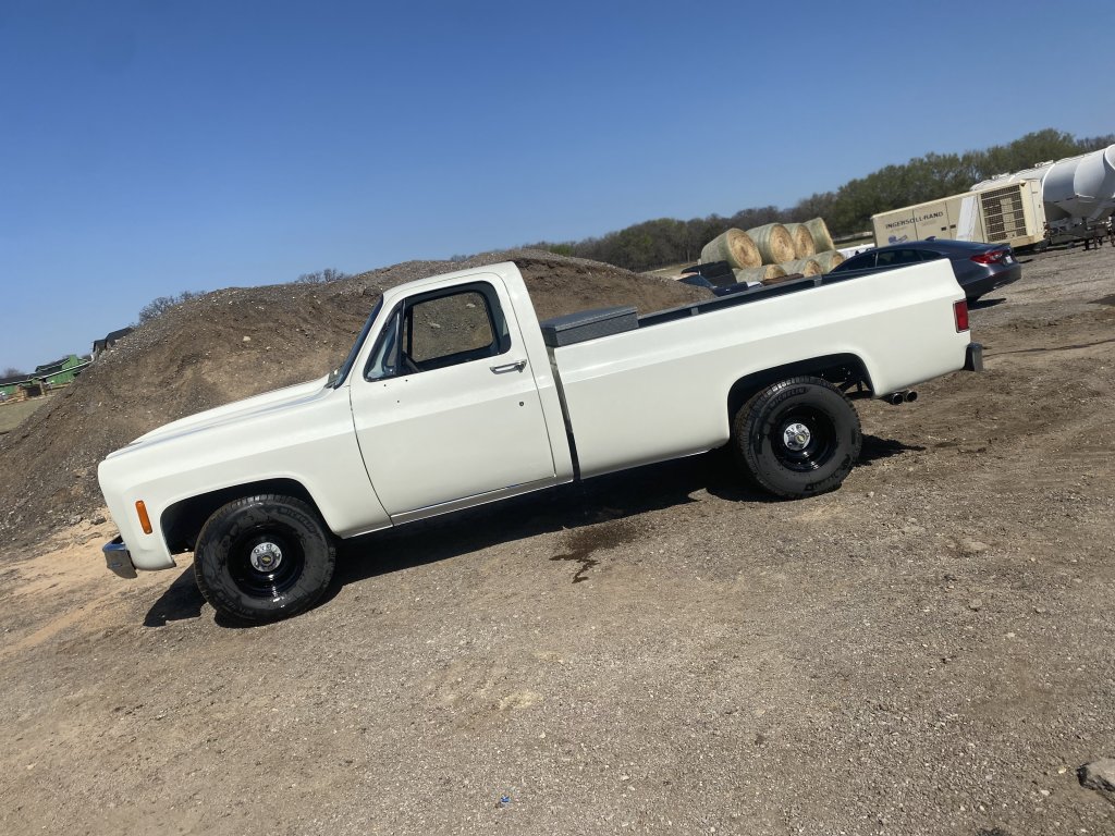

We are looking at a Western Chassis 2/4 drop. Want to see some pictures when you are finished please. He’s 15 and on the fence….
Thanks and good luck!

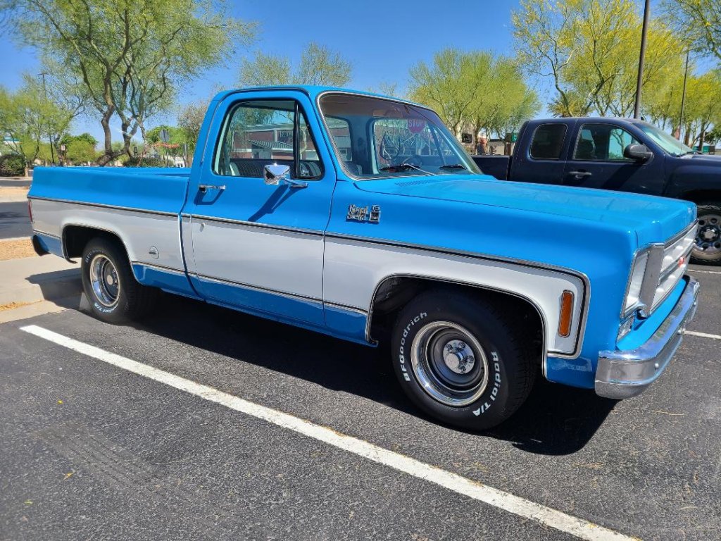

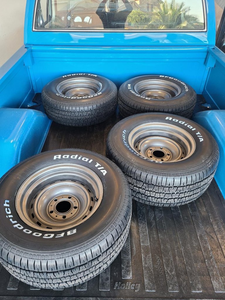

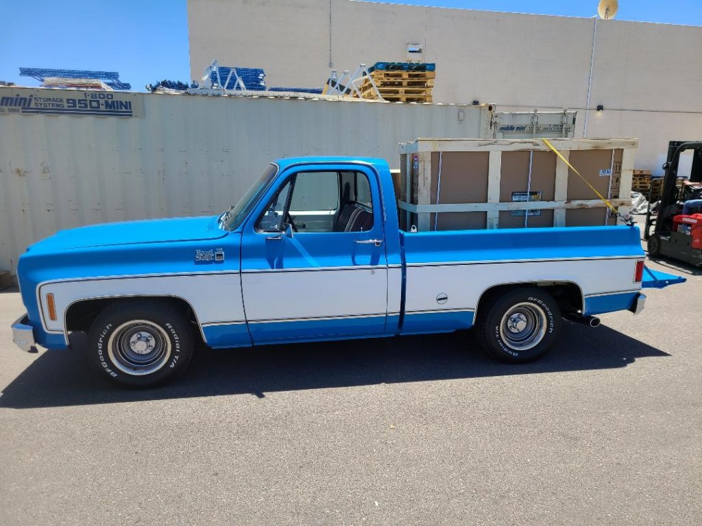

Ended up going with 3" lowering coils and 4" lowering springs and shackles. Also got a new set of shoes. 235/70/15 fronts and 275/60/15 rear. Sitting about 1" higher out back I like the way it looks and rides nice.

Very nice and super clean ride!

If you want tire at or under lip of fender well I would recommend flipping and c-notch the frame. You can get leaf springs redone to whatever height you need and not expensive.

If I wanted that I guess, I would have bagged it? Didn't want to C notch the frame. Low enough for me. Can still tow something the way it is now.

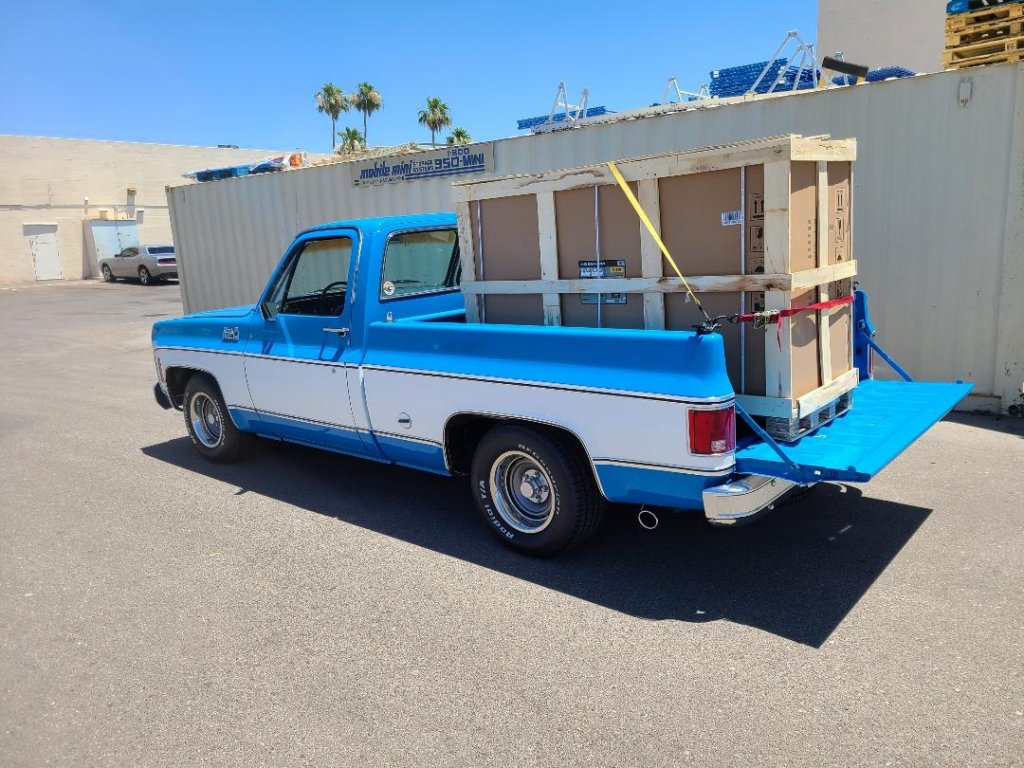

So glad I didn't flip my axle. With over a 1k of payload, rides like a dream! Also just got a new 2 1/2" dual exhaust system installed.

Look great, even with the load in the back, the stance is really nice. Good job!
