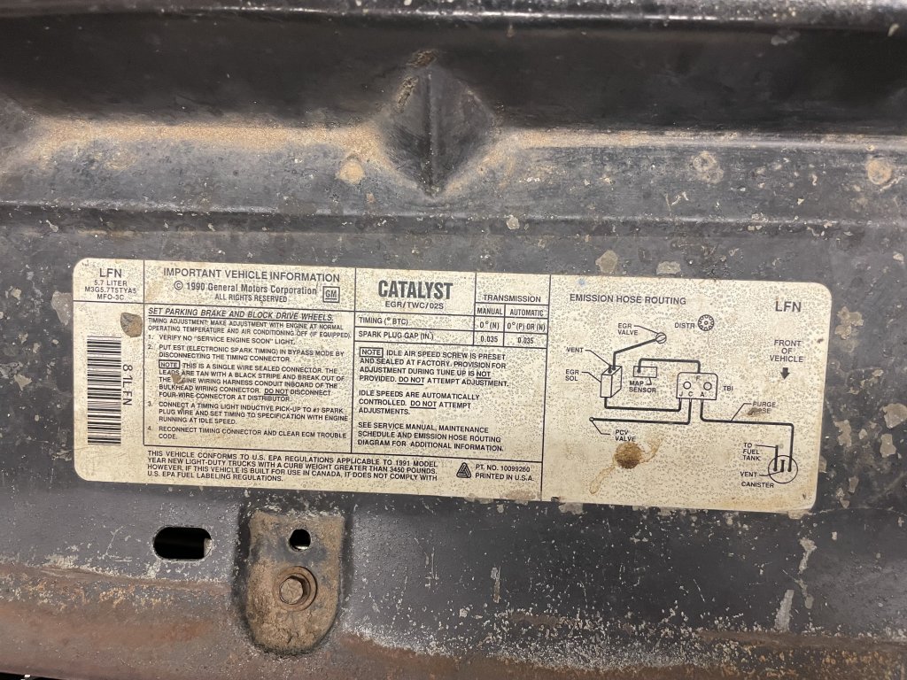

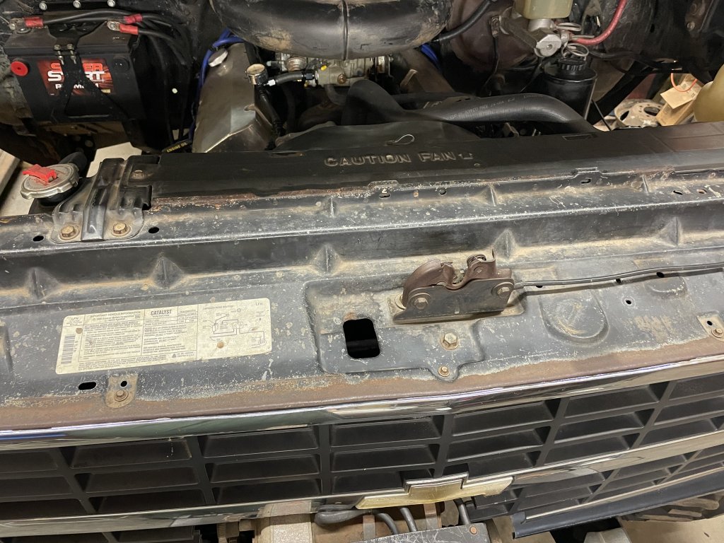

I thought I had 2 stickers on my core support but there’s only this one. I don’t have the factory air cleaner, a/c box or wheel wells so no other stickers.
Here’s the placement and a close up.

Joshua and John, you gentlemen are awesome! :cool:
thank you very much for taking the time to show the pics of the decal/sticker and another showing its location, that is exactly what I was hoping for :happy107:
now to find a website that can make em if they don't already have created them

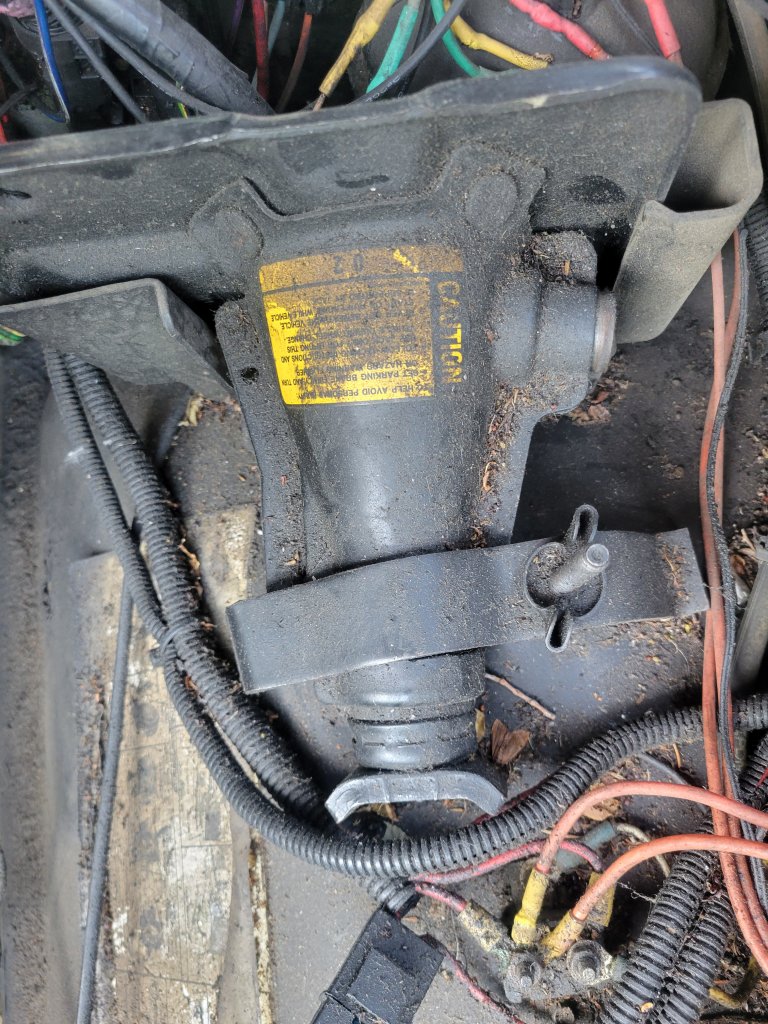

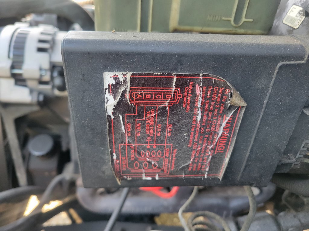

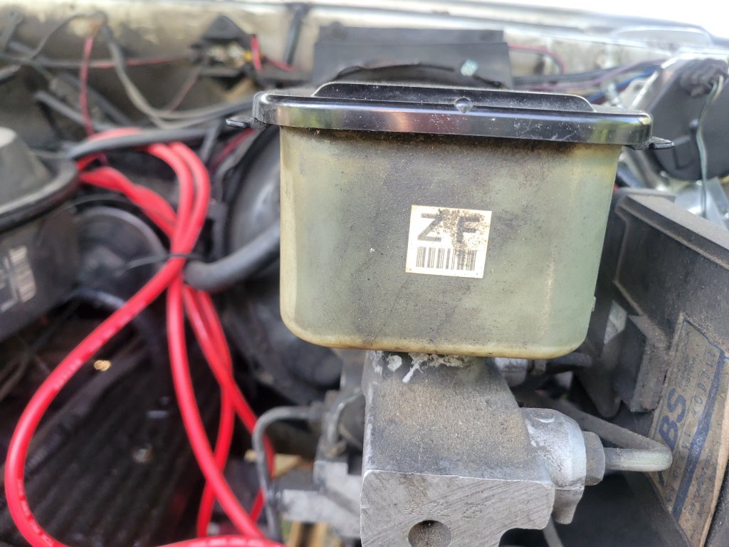

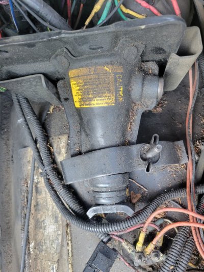

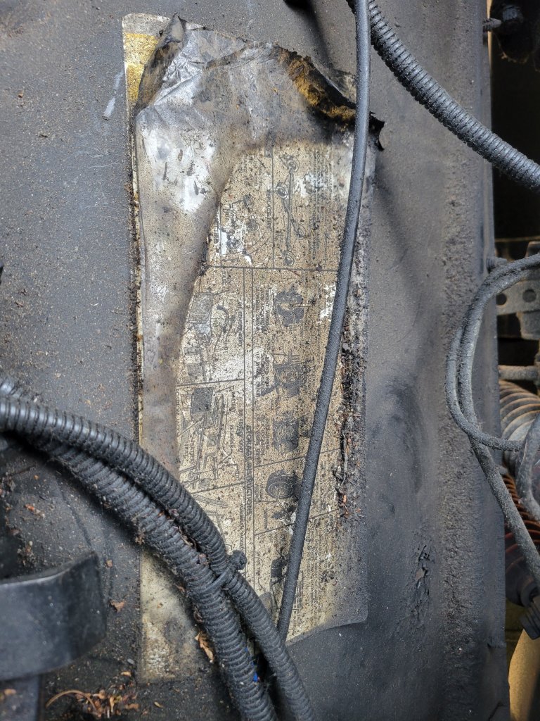

this is every sticker I can find:)
jacking instructions
jack sticker
RWAL module sticker
brake reservoir sticker

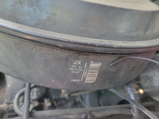

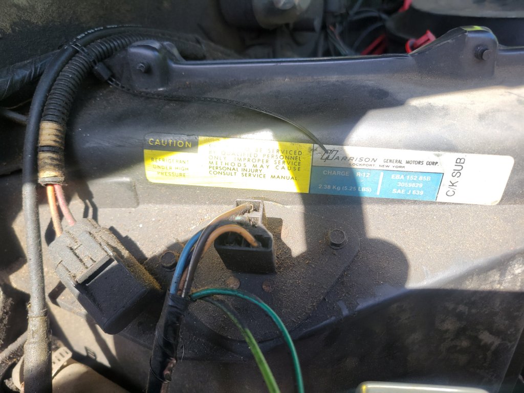

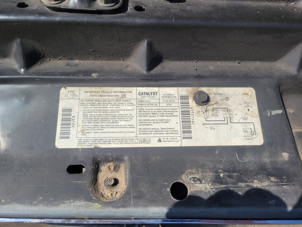

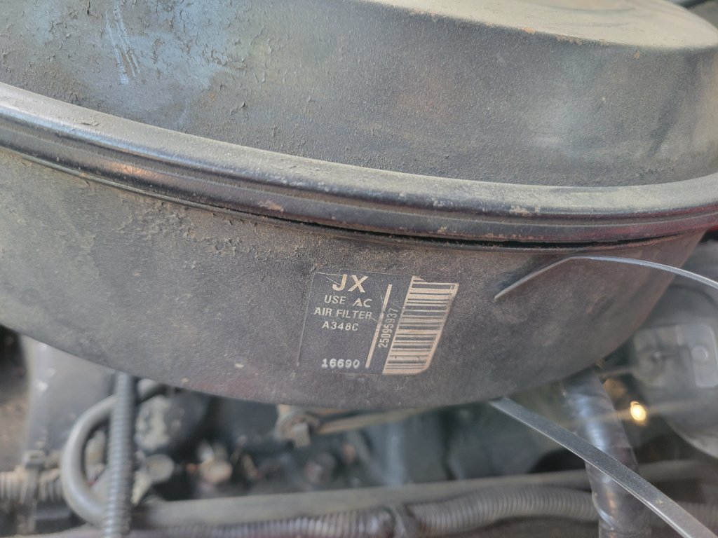

a few more that wouldn't stick in the first post.
air cleaner
tbi vacuum routing
ac

Shouldn't be one on the air cleaner on light duty trucks. They were certified different. Heavy duty,the engine was certified so the emissions sticker went on the air cleaner. Light duty the vehicle was certified so the sticker went on the vehicle core support.
