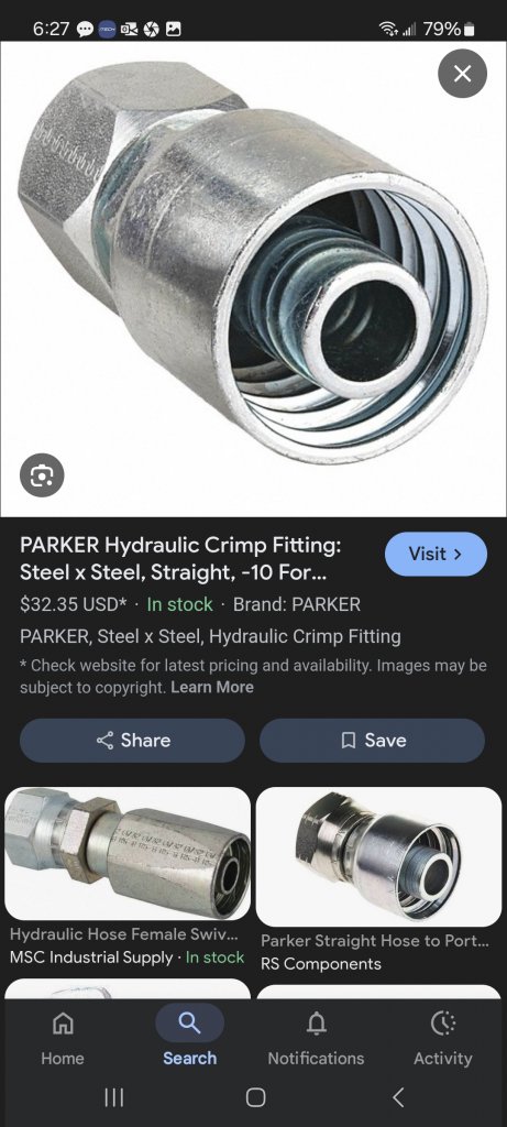

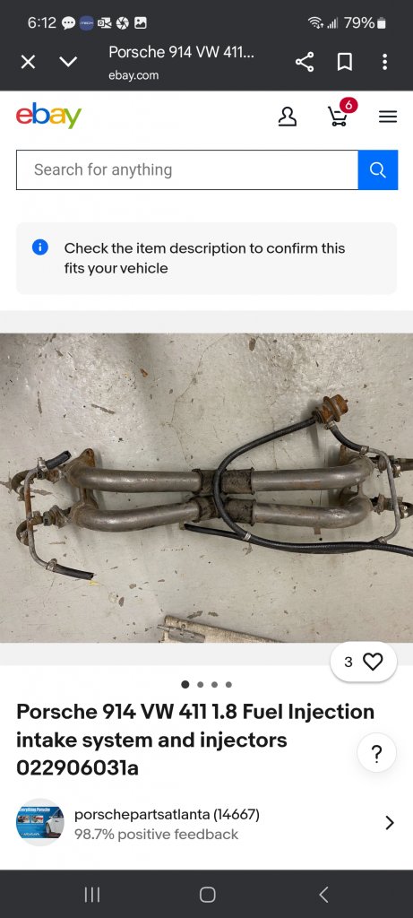

It's 15-20 lbs on the pressure side return side is very low. And if you are concerned take a look at an older BMW,PorscheAudi,Volkswagen,Mercedes,etc That had Bosch D jetronic,L jetronick or K jetronic,even the old Nissans,they were running 35 psi through injection hose and injection hose clamps. Pic of the type clamps,and some ebay 914 injection stuff for illustration purposes. I wouldn't like it pressure side,I don't like pressure side on carbs I make steel lines. But if you can't find what you need especially low side( return ) I'd use good hose and good clamps. If you split and peel a factory crimp you can usually use the factory ends. Sure I'd rather have the correct line,but done right I wouldn't have a problem using a well done hose and clamp repair temporarily as many years as it took to find the right parts. Watch at least the first few seconds of this video,the clamps are explained.
