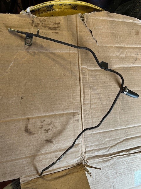

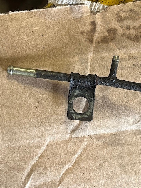

I am trying to revive my father's 1986 GMC Sierra. We have it running and starting well, but a leak in the fuel return line in the front of the engine has occurred. We cannot locate a replacement and wondering if anyone can locate the line pictured or if we need to build one out of Viton. Thanks for your insight.

Many decades ago I made one out of brake line. It wouldn't hurt to flare the ends and use clamps.

Thanks Rick! The only challenge I see with that is the actual line is 1/4" but it narrows down to 3/16" where the rubber return hose come off the injectors. I guess I can put a reducer in line to get it back down to 3/16".

weirdly enough aftermarket they make the tank to frame rail 82-83 style water in fuel siphon line, but not these. odd. yeah just make one out of nickel copper. I might have one... i can check.

Cool project bringing your father’s Sierra back to life. If you can’t find that exact line, a lot of people just bend a new one from steel or NiCopp and reuse the fittings, or run a short section of Viton fuel hose in that spot. Should be a pretty straightforward fix.
