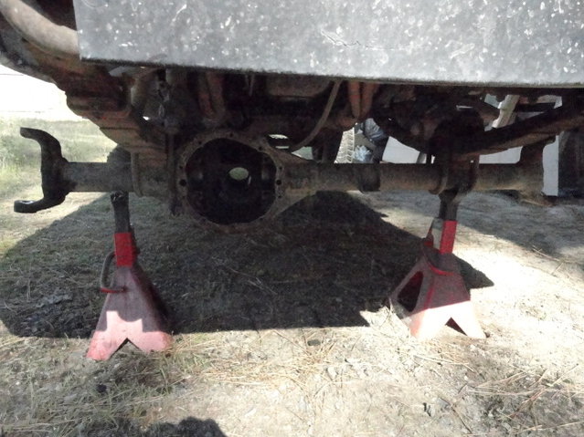

What is pictured is not actual kit (hate when ebayers do that, I want to see what I am actually getting). The reason I was thinking of this was that my outer pinon bearing had side to side slop in it when you grabbed the yoke, carrier bearings are still good and gears look good...everything is original though, so no clue how much life left in them. I really only need to do the pinon bearings, but since the basic kits I've found come with bearings, ring and pinion for around $170, thought I would go through the whole mess since I have it down. I know this 10 bolt won't last with the 37's, was hoping to just get it till winter, hopefully can find a 60 by then.
What I have in my truck is a 10 bolt and it's 28 spline, it should be an 8.5" ring gear correct?
