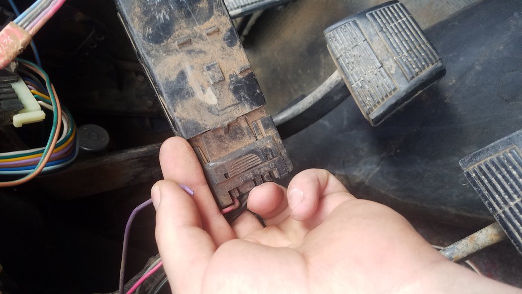

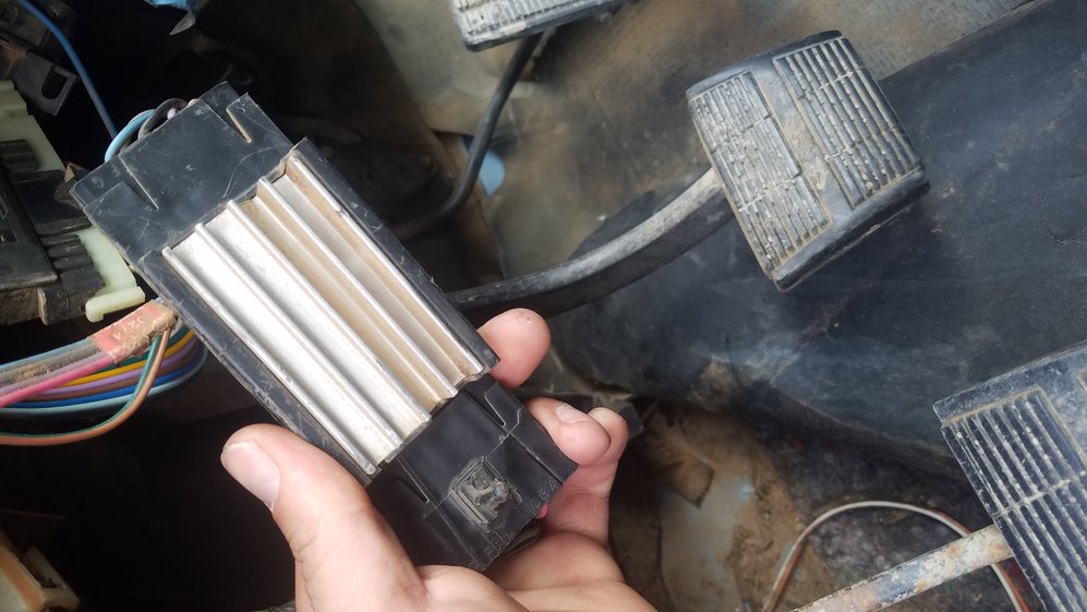

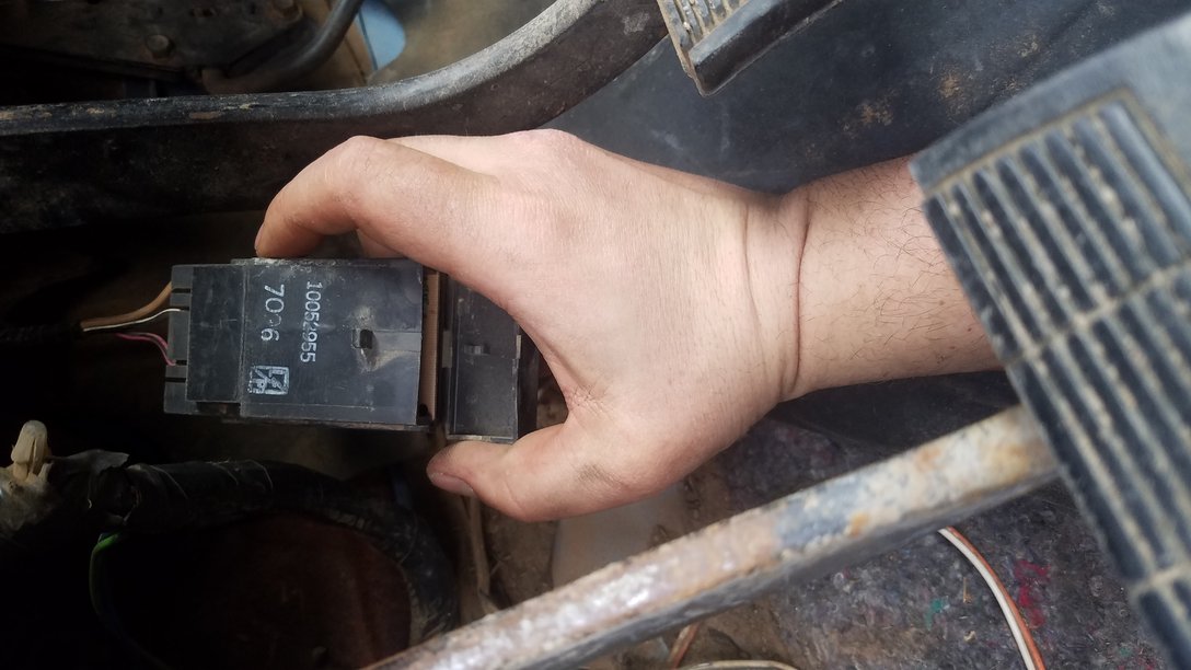

I have a 87 v20 4x4 350 3speed. It was a ranch truck untill i bought it back in October. It needed a fuel pump relay and a new pump. Got those things worked out and it runs great. Unfortunately just yesterday it would not crank. I could hear the pump prime but the starter wouldnt kick on. The wire under the dashboard is a mess. Ive narrowed it down to the fuse box area. But my knowledge of what should be there isnt that good. I dont know what should be there and what was hacked back together. Would someone please post a picture of what it should look like under the dash near the fuse panel. Also what are these? Today while under there i was able to end up getting the truck to crank but not fire. And the pump is not priming either. Im not sure what i did while i was under there besides shaking wires around

On a side note. The purple wire on the pulse wiper module is cut. What specifically is that one for?
The PPL lead supplies the ground path for the wiper motor's high speed windings.
