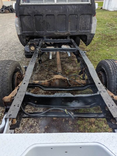

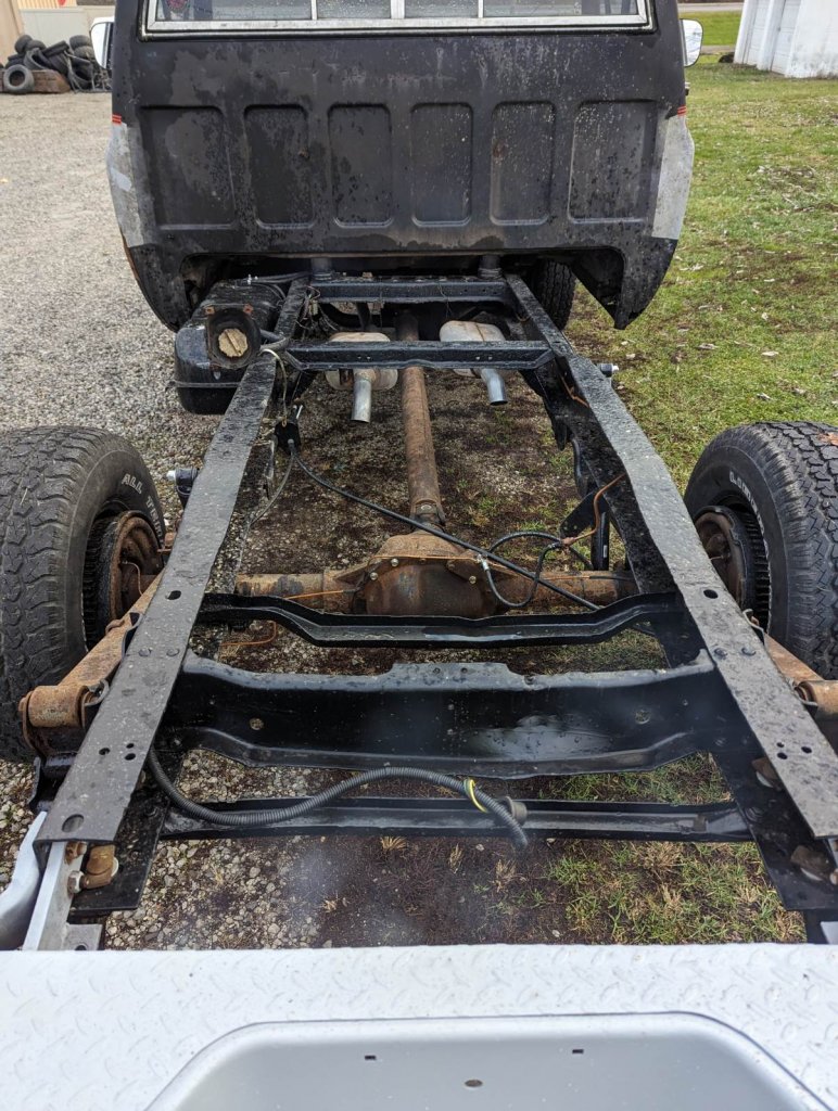

How do you know the rear axle assembly is misaligned? There is a small dowel or centering pin located on the bottom of the leaf springs where the axle tube is bolted to the perch. If it is not centered and in the hole, you will see a gap between the perch and the bottom of the spring. Usually, the only reason the rear assembly is out of alignment is someone has previously removed it and did not properly reinstall, or there was damage from impact.
Josh577
Sep 10, 2023
22
waverly ohio
josh
i dont know how i didnt see it before
