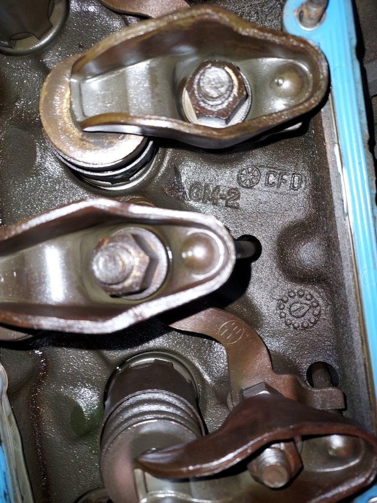

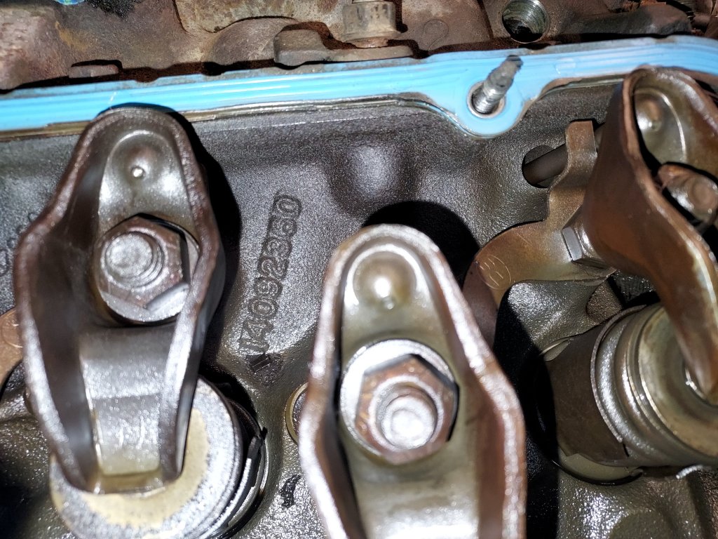

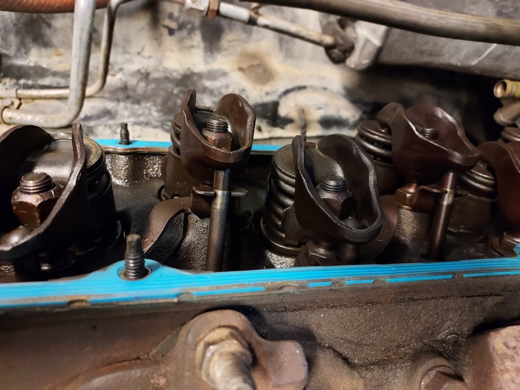

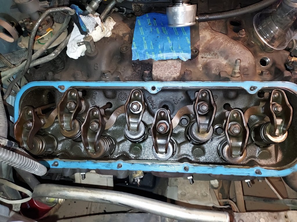

Does this look like ahead with 326k+ miles on it? You can one tell from a stupid pic?
Just curious.

Not peanut port but the larger oval port. If made in the early 1970's it would need to have had hardened valve seats installed sometime in it's life as the early 70's did not have flame hardened valve seats. Over a 1/4 million miles, sure!
As stated would have been on a passenger car. I would need to find my book for more correct info. Possibly from a 402 or 454 as they shared some same heads.

These are peanut port from the #14092360
I originally planned to fix two broken exhaust bolts, then figured if pulling one...and if needs remanufacture, should do both, then realized I'll have everything off and gonna just redo whole engine. Now is the time anyways.

Yes, when researching those heads I got wrong info..
Peanut port heads are good for low RPM torque, but get all choked up around 4500 RPM. Peanut port heads are on my 1998 3500, with a 454.
Same answer to your first question. Those old low RPM big blocks just keep on running. So yes they look like 326K. Your second question, no I could not tell from your picture. I needed to see the intake ports to know they were peanut port heads. I believed what I found researching the casting numbers.

Oh, no, you're all good. I meant can someone tell if they have miles on them from pic. I just thought they looked pretty dam good and was surprised. Was concerned I was rebuilding something that may not need it.
Texting sucks for communication sometimes, and I was probably not clear.
Thanks for your feedback Brother!

It is a bit tough to tell from the angle of your photo, but it appears there is a big variation in the amount of threads exposed on the rocker studs. As a rule, that is not the case on a fresh or low mileage head. It is the first thing I look at when removing a cover. Part of diagnosing problems.
I would never be concerned with freshening something up if you do not know it's history.
6,445
10,970
Depending on your funds,on a tight budget,vacuum or solvent check the ports for seal. Preferably vacuum. If all ports will hold vacuum check the tops of the valves for front to back,side to side motion,not much wiggle at the tops of the valves all ports hold vacuum,change valve seals if you have the ability and they'll run a long time.
