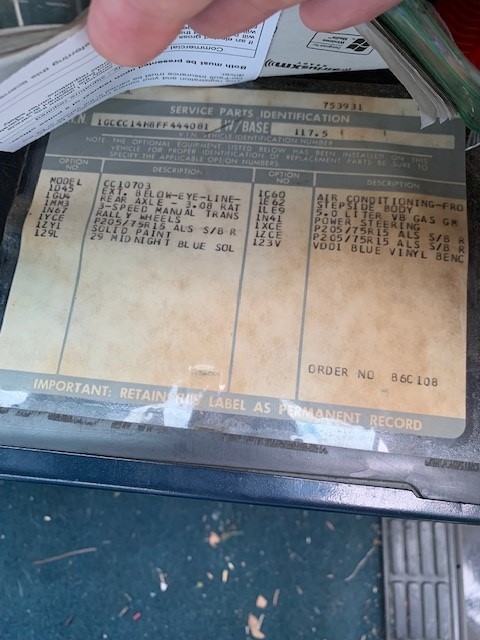

sorry to hijack old thread, but I'm running into similar situation - all of the aftermarket parts places are using the "total rotor height" dimension to differentiate, but with no clear direction as to what that means.
@Keith Seymore , from my lurking here you seem to have the most knowledge on such things - My truck is an '85 stepside 305 / 3 on tree with manual brakes, is it safe to assume that's the JB1 RPO and likely the smaller 4.65" height?
