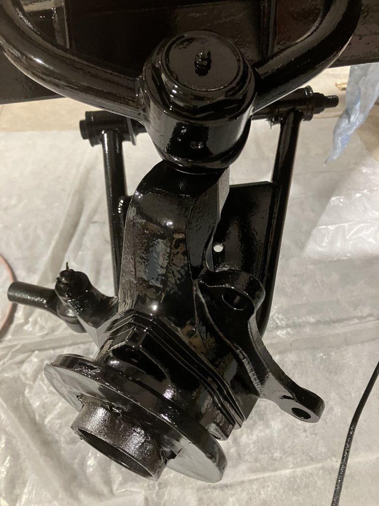

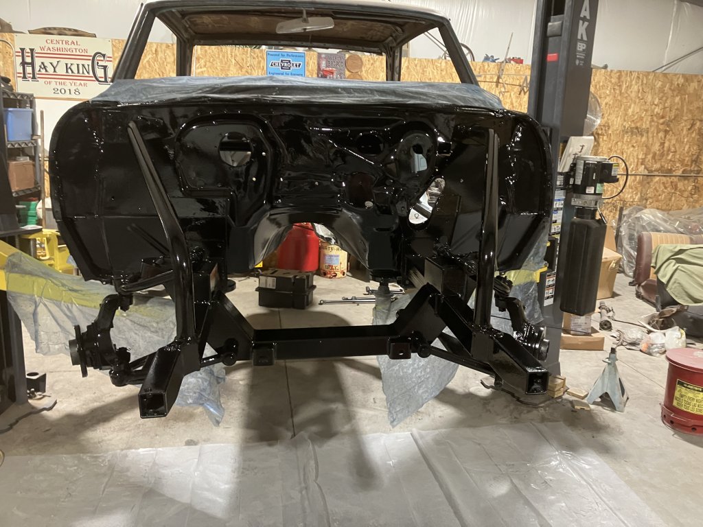

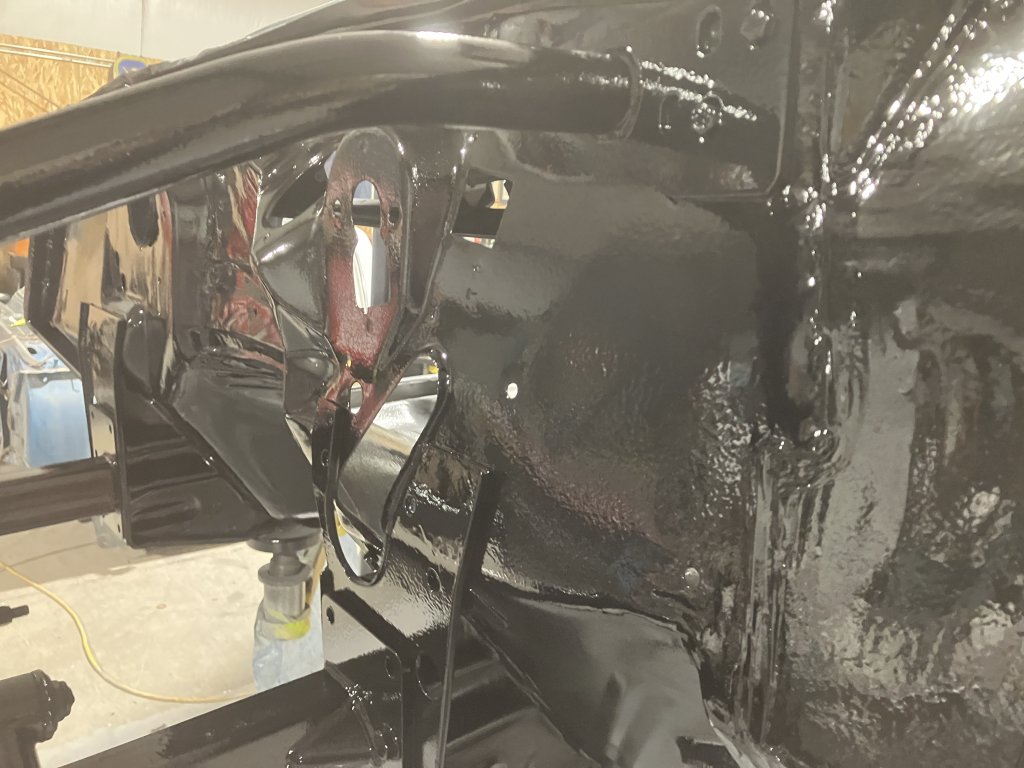

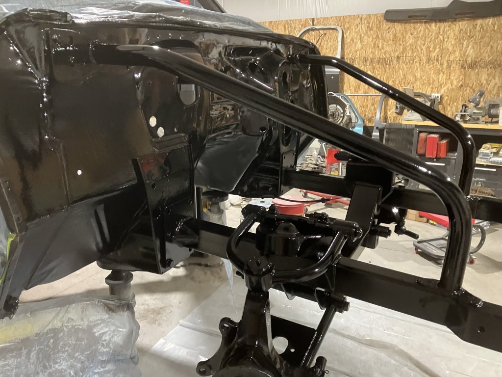

You can also use a flattner, but you will need a gram scale, did that to my Nova. There are mixing instructions for different gloss, more flattner= less gloss. This also uses a clear coat. Local paint supply. CalSgt is a trusted source, like most on here. Your choice will depend on just how picky you will get with the resto....if you're go to that much trouble, may need testing against some original. Close enough for my Nova. I have also used the summit epoxy primer, make sure you get the right Catalyst, as summit steered me wrong and it took a long time to dry. Also use light primers for light colors, red, yellow, white lt blue, but use the dark gray for darker greens, black, etc, you get the drift. My light gray primer took six coats of Emarold green to cover, where dark gray was the desired color to use, but missed that when I was looking at the paint instructions.
