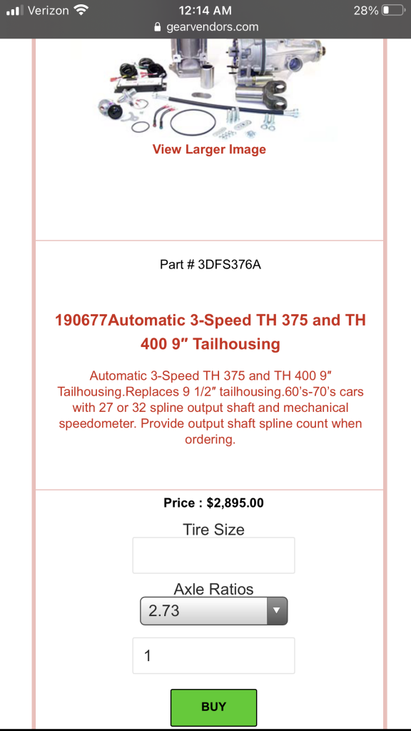

I bought my gear vender off eBay (the only thing I have ever successfully bid on!) for 900 bucks, the controller cost me another 300. I just looked on gear venders price list, a 400 gear vender package is 2900. I’d be real surprised if you could do a gear vender conversion for less than 3300 by the time you have driveshaft made, fluids, and all the other nickle and dime crap is done.
If you can find s hood used 4L80, the trans and required controller would’ve well under half that amount.
