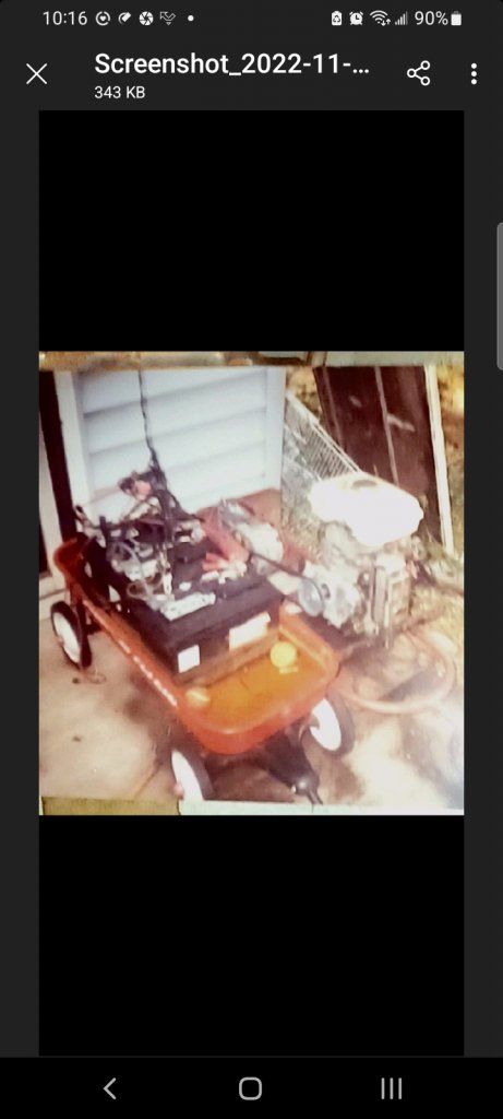

@mtnmankev I feel your pain I was without electricity 6 months 1 year I built this with a Honda tiller motor,a gm alternator,3 boat batteries and a 1500 watt power inverter wired to the house. I ran it in the morning to bring the batteries up and again in the evening to bring the batteries up. Couldn't afford to run a generator 24/7 painted bleach bottles black and left them in the sun all day for hot water,shower was a garden sprayer with the hose changed out to a kitchen dish sprayer hose,worked great more pumps more water pressure.
