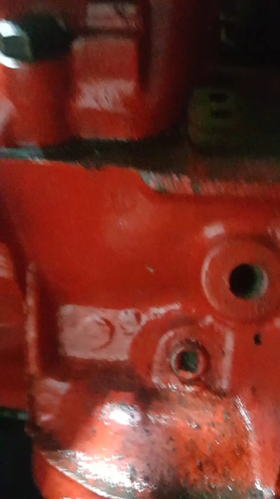

Followup question. Havent found the one by the oil filter but i do have a 3/8 plug w a squared center. That is neither 3/8 ratchet or 1/4. How do you get that f out?
Between 1/4" and 3/8" is 5/16". Get a piece 5/16" key stock.
Grainger, NAPA and others have it. Hacksaw a piece off and use a 12 point socket or open wrench. You can also buy female square sockets. The key stock works like an allen socket.

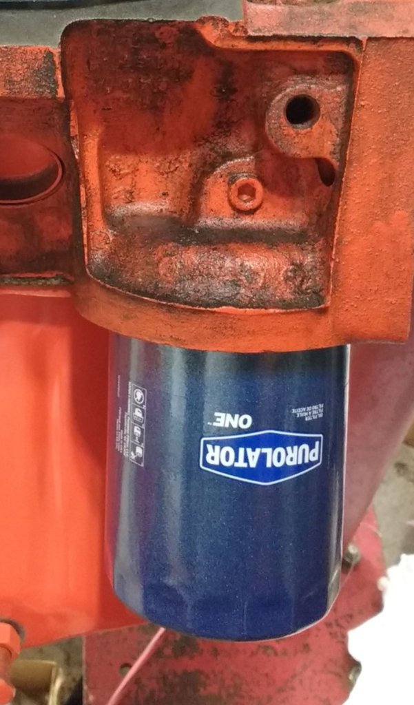

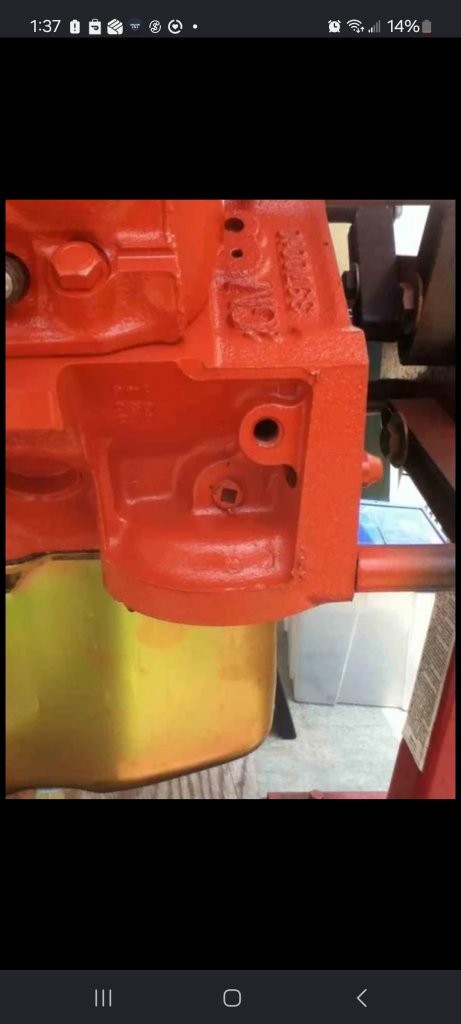

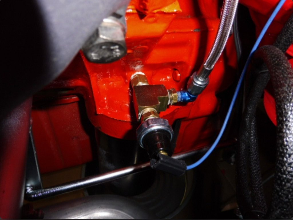

Right above the oil filter
