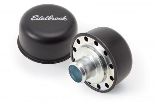

Definately need more than just the pcv to vent. On my valve covers where you put the oil in it has a push-in vent, like this...
attachment.php

Thanks guys I was really thinking it could be the pressure, when I was up at Autozone they had a chrome Edelbrock breather, so I got that, put the new cork gaskets in, and replaced my oil plug with the breather, and bought a new PCV valve, so I guess we'll see what that does.
