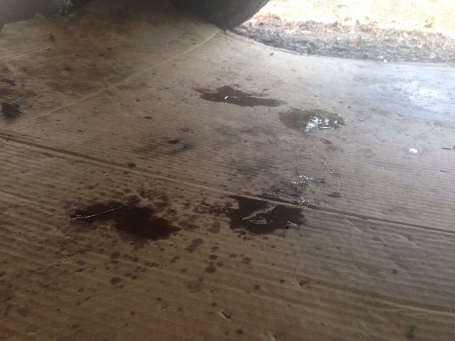

I just noticed a motor oil leak I have dripping right in front of the tranny pan on both sides. the truck doesn't have a flexplate cover on it so I'm not sure if it's running down the block from the black of my valve covers, where I can't see, or maybe I picked up the wrong oil filter by mistake. It only leaks when the truck is running. Just curious if any of you guys have any similar occurrences or any suggestions. Thanks

Or maybe oil pump? I don't know why it's dripping on both sides though

Well it definitely looks like the oil pressure switch. I'm almost 100% sure it isn't the valve cover gasket and it doesn't really look like the intake manifold from what I can see. I guess All I can do Is fix that and see if it still does it. But would that really make it leak that much just from giving it moderate throttle for 20 seconds or so?
