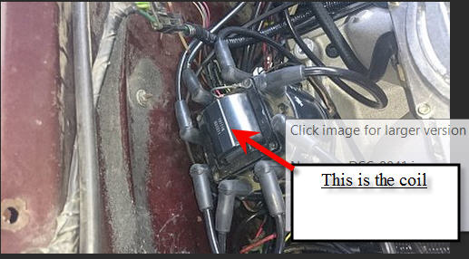

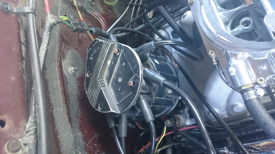

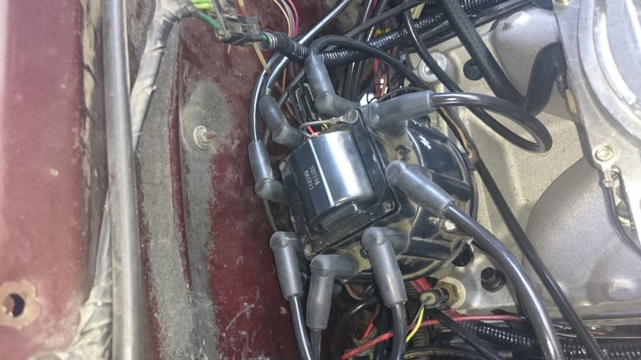

I've been reading some guides on diagnosing a no spark condition but they lose me when they start talking about the ignition coil. I think my distributor is setup differently. I'm going to post some pics here of what I have.

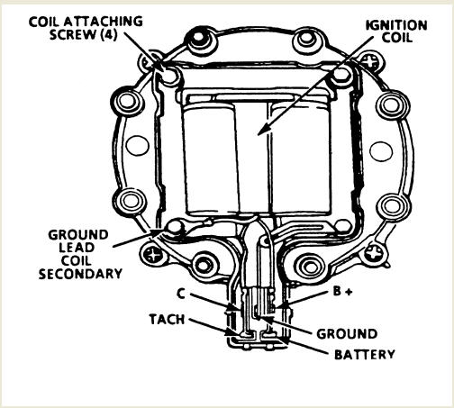

Maybe this will help. Check for positive 12 volts with the ignition on at the terminal labeled battery.
