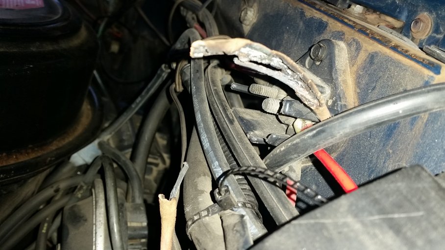

Well, would ya look at that...

Off to the parts store I go for 2 new fusible links.
Is a burnt link "normal" from age or do i need to do some searching for a cause of this?

Update: New links installed and truck is rolling once again. :cool:

Oh boy! I wish you luck.
It may well be that the cause of failure was the link just got old and self-destructed, but my gut tells me otherwise.
From what I can see in the image, it certainly looks like that link failed due to an extreme over-current condition.
I wouldn't be surprised if it happens again. Many wiring faults are intermittent and get worse over time.
There is quite a bit of wiring on the downstream side of that link. If there is a break in the insulation anywhere in it - and it caused a short circuit to ground... it will come back to haunt you.
Might be a good idea to keep another link - and your crimping tool - in the glove box.

Oh, I'll be picking up a couple more to keep handy until I can isolate the cause.
