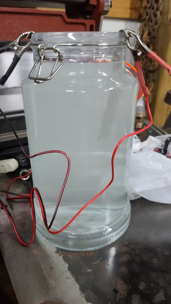

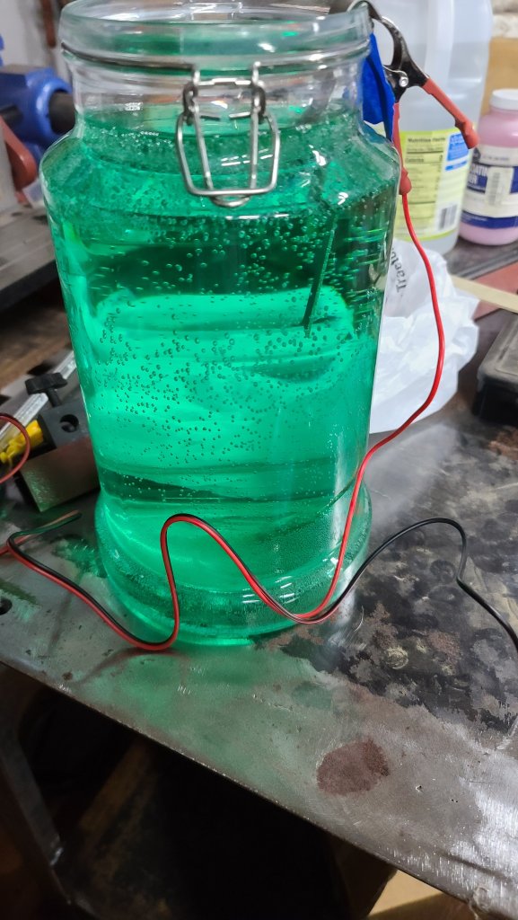

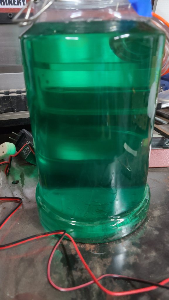

I have started this. I finely found a jar that I thought would be suitable for the processes. I just started making the Plating solution. I'll post a pic when It is done. It's supposed to be Green...We see.

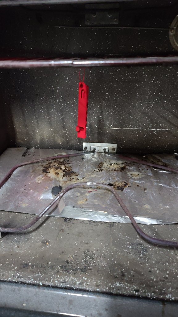

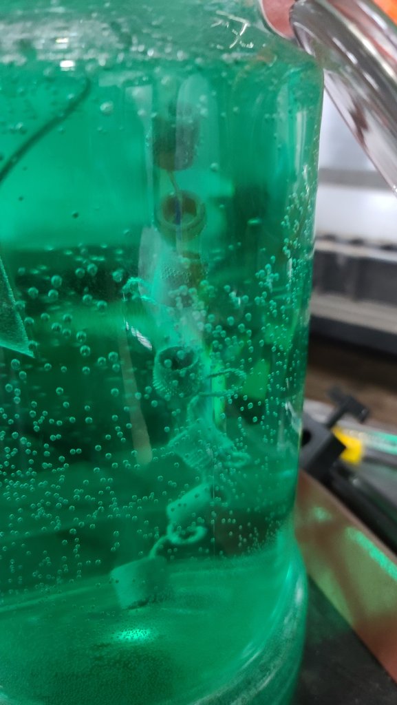

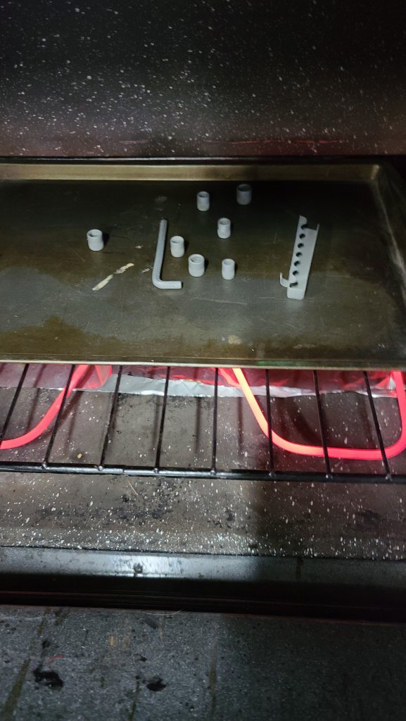

Ok I bought a little set of sockets on epay 8.00 shipped. I really liked the set in the video. Just thought they were cool. Anyways, Sandblasted the set, wired wheeled them, cleaned them with Acetone, and than out gassed them. Hung them on a wire, and put them in a Plating solution with the POS + on the other strip of Nickel, and the Neg - to the wire. Let sit in the solution for about 30 minutes. I powered coated the tray in red. Took them out of the solution, and polished them by hand. It didn't come out as shinny as I thought it would, but all in all I'm very pleased.

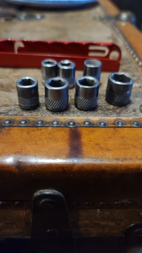

I think maybe next time I will polish them a bit more. I know I was told what you put in you should get out...

That solution should be a much darker emerald green, probably pretty diluted. May have something to do with why you didn't get a great coating. Also a raw nickel coating is not shiny, it will come out looking like a matte grey color (maybe "semi gloss" in some situations), needs to be polished a lot to make it shine. Think like the look of a galvanized zinc coating minus the weird checkerboard pattern.

I think I didn't have enough Nickel. I was also told the more I use it the darker it will get. I'm thinking about getting a few more strips of pure Nickel, and making it a bit darker.

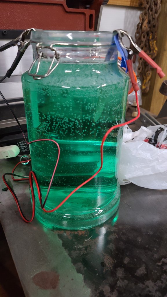

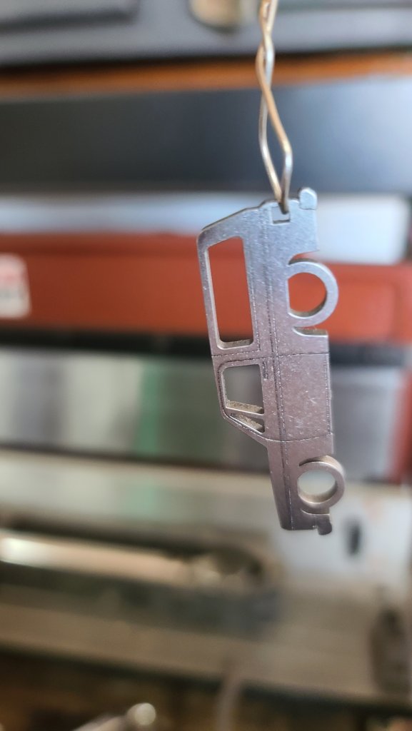

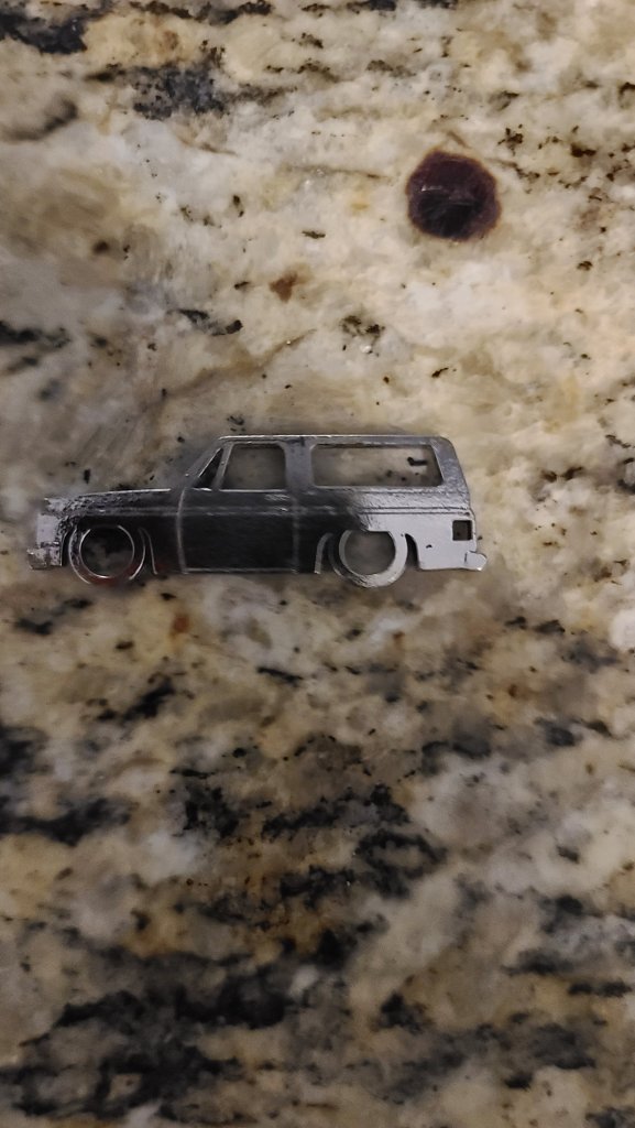

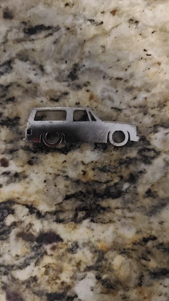

Ok made my Nickel solution a bit darker. Got a 2WD Blazer key chain, so I'm nickel plating it. I'll post other pics when its done.

Pretty happy with the way it came out...pics don't do it justice.

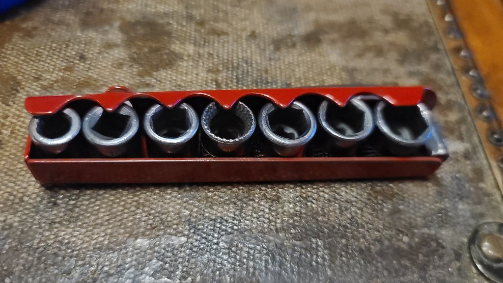

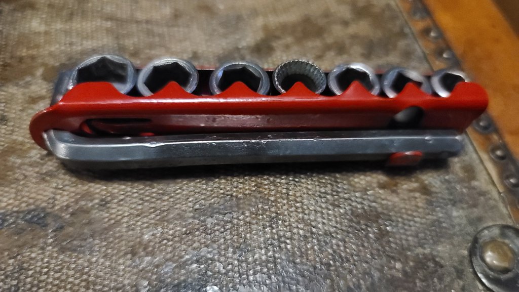

I finally remembered to get a couple pictures of my little socket set. I forgot that the Allen wrench was actually a special one, with a detent ball and a couple socket stops.

You need to send that to me, and I'll make it look nice and new...
