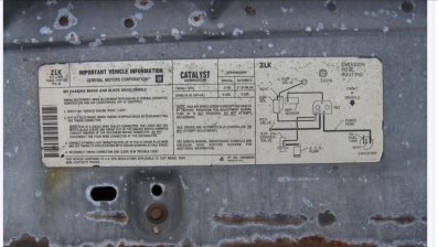

Yup, ignore the ridiculous underhood sticker. If you happen to get pinging with 12 degrees, back it off a couple or just run a higher octane fuel.
FWIW, the guy's over at GMT400 (my DD is a 95 GMC TBI), swear up and down that anything more than the factory 0 degrees causes knocking.
Kinda blew my mind, I've never seen a motor that didn't enjoy some timing.

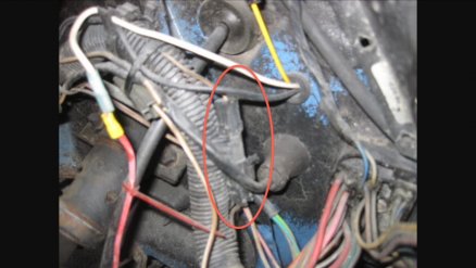

The esc plug is right here between the steering column and the bulkhead connector through the firewall.
