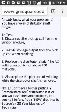

Just purchased an 88 2500 suburban 4x4 with a 5.7,turbo 400,3:73,tailgate.
First time suburban or 4wd owner. Surface rust passed smog no problem interior is fair. 500.00. Runs excellent except it stalls when i come to a stop in gear. In neutral its okay. I'm thinking my dizzy is cracked somewhere.
I read that if the magnets are weak it will stall in gear.
Any thought?
Thanks,Stomp and Steer.

This is what the pro said.....
