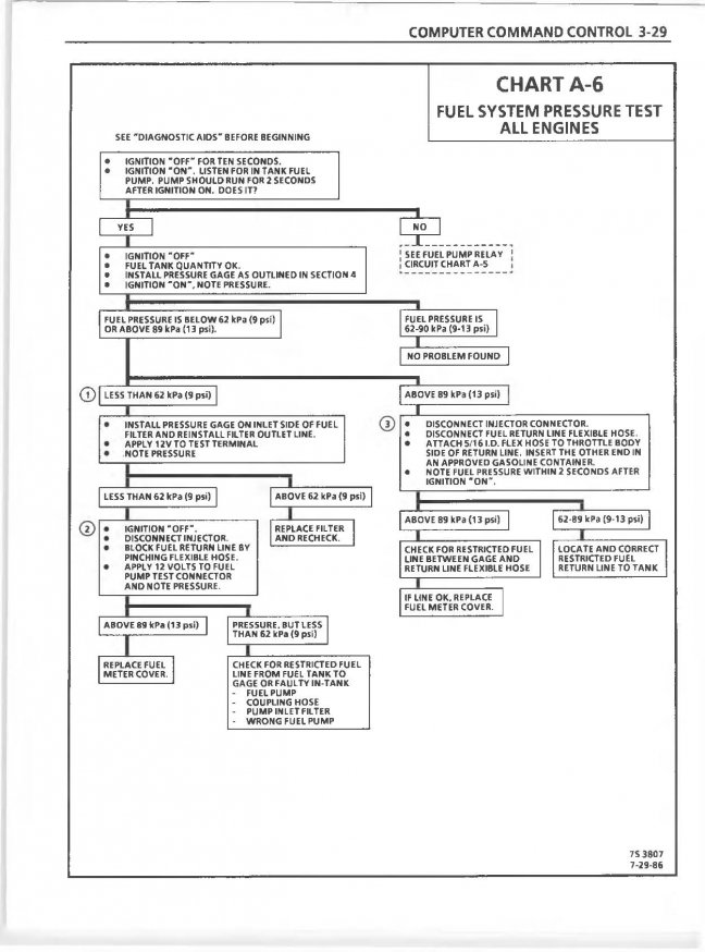

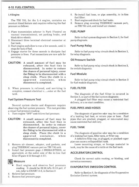

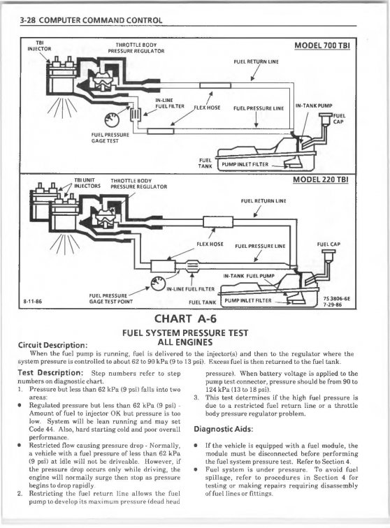

Some info on fuel system testing and operation. From the 1987 GMC_Light_Duty_Truck_Fuel_and_Emissions_Including_Driveability Manual.
Link to full book (262 pages) good info - download and save:
http://depositfiles.com/files/rblr611g2
Is it possible (assuming everything has had time to dry out) that when you crashed through the ice, you might have pinched a fuel line?
