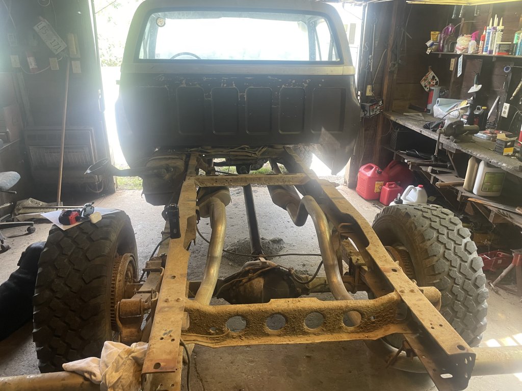

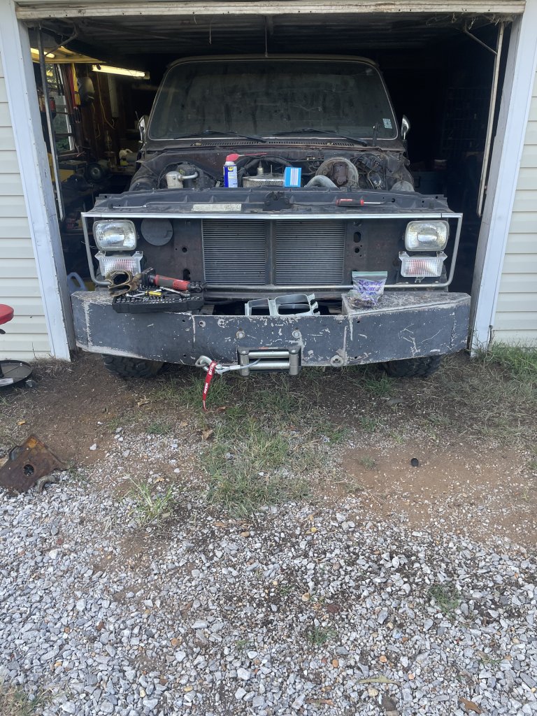

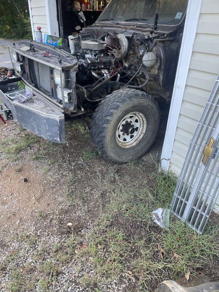

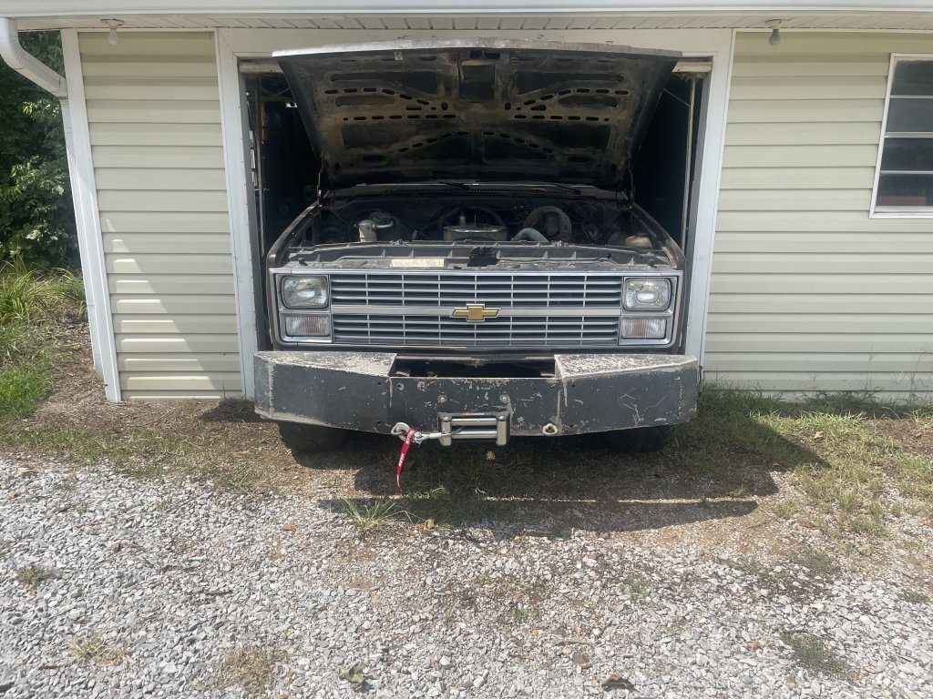

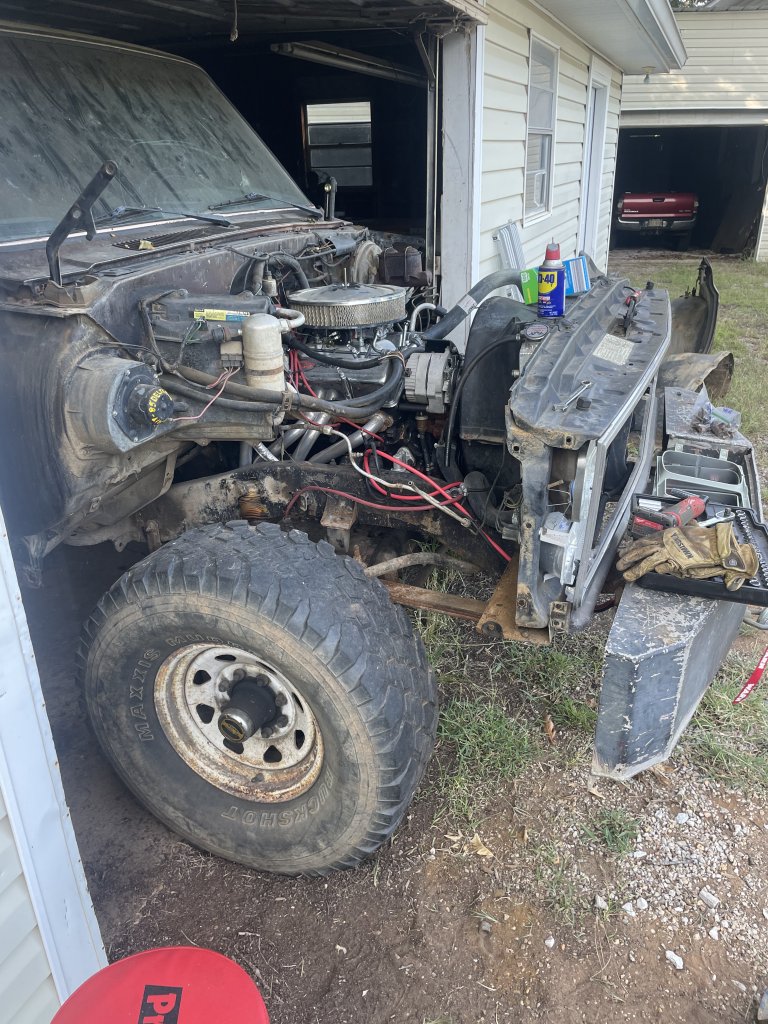

Hello again to all. As you can see it has been a while (YEARS) since I've worked on the truck, lol. It has honestly been tucked away for too long now. I decided to go ahead and finally start the complete tear down and freshen up. Got the bed removed and started chipping away at getting the rig stripped completely down to start with the frame. I plan on documenting this build and hope to share with everyone along the way. God Bless!
