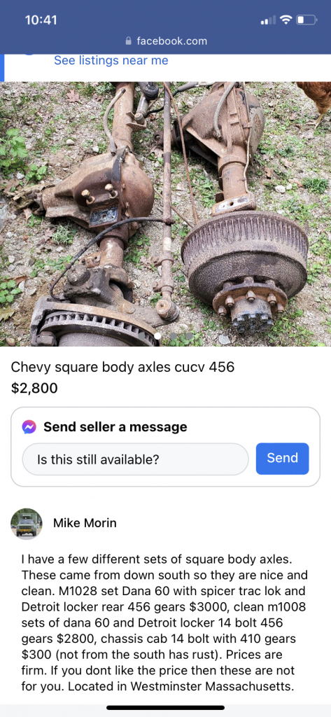

Then I’m thinking about these to purchase for the summer sand blasting and painting. Not sure if m1008 or M1028 would be an easier bolt in for a suburban.

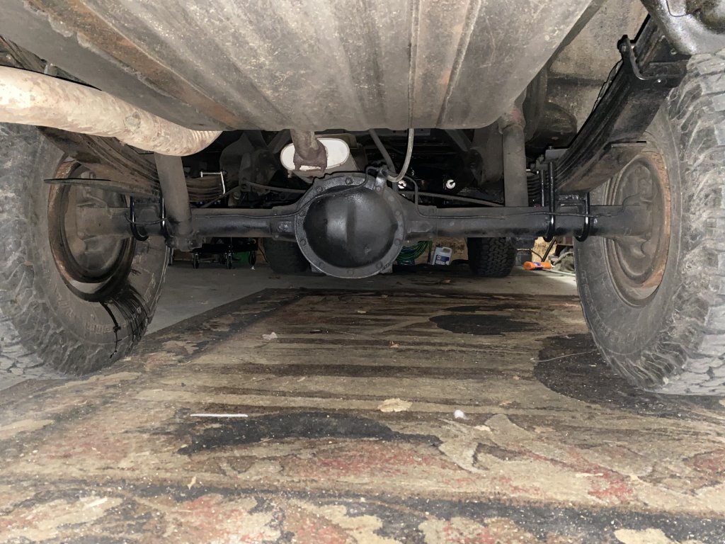

The chassis cab axle is narrower and I don't think it will even fit between your springs. Here's a shot of the rear end on my SRW K30. You can see the shocks are opposite of yours and on the inside of the frame, but if you didn't know, C/K 30 trucks have the springs inboard of 1/2 and 3/4 tons (narrower spring hangers). One benefit of going with 1-ton axles is you get 13" x 3.5" rear drums. 3/4 tons are 13" x 3".
