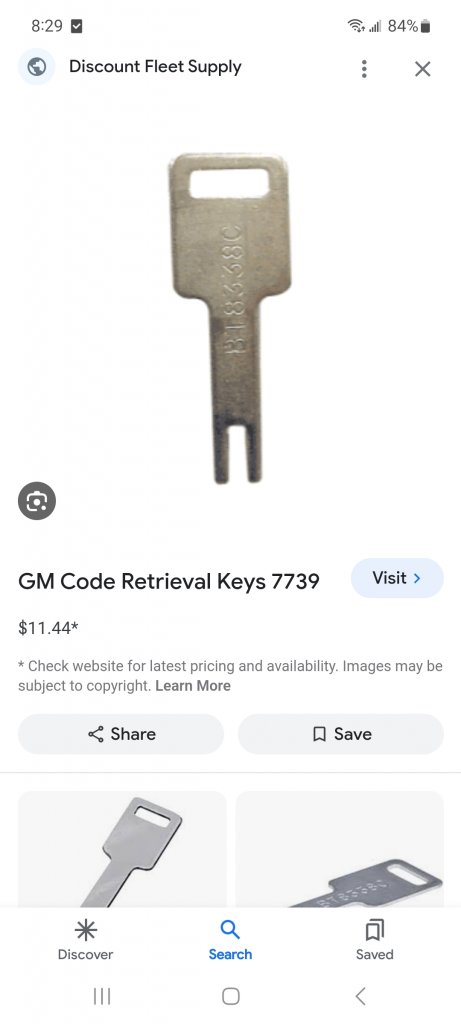

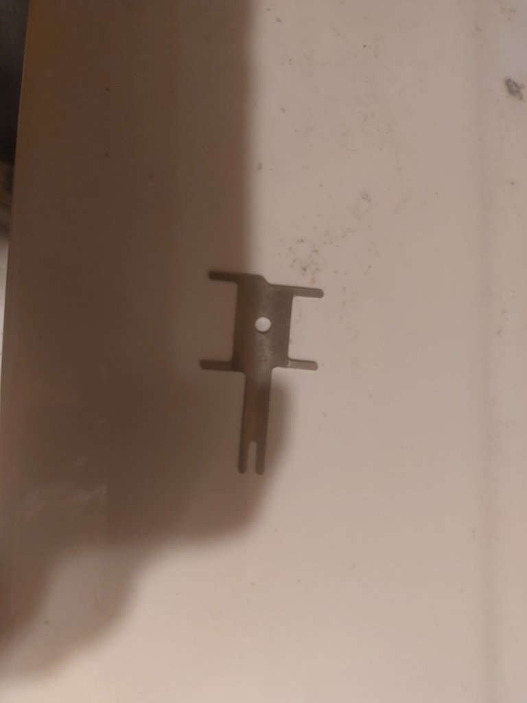

Sure,but why would you? The piece of wire is free. We use to have a special key. I still have one,not on me though for reading gm codes. I'll get a pic, the 2 close prongs do engine codes, the other 4 are ABS. I lost my key that does just engine codes,I'm sure it's on a key ring somewhere it just has the 2 close prongs. You just stick the 2 close prongs into A&B and count. The only scanner on one of these I'd want is a tech 1 or snap on red brick. But for most people shorting A&B is all you need. Found a pic of one on the internet. The price is steep if you ask me,but it is convenient to keep on your key ring. Somebody use to give them away,I thinknit was our snap on man.
