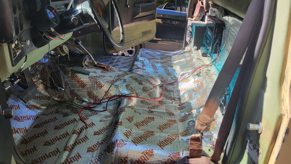

Just did my floor yesterday, I used kilmat.
