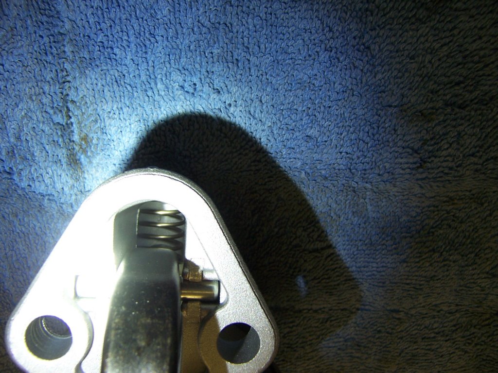

Get a Delco or Delphi pump. Been through bad pumps a couple years ago. Other than the 2 mentioned none I tried had a return spring. Arm stuck down. Picture is a Delphi pump.
Also, if the tank is dirty, it is possible for dirt to become lodged in the check valves inside the pump. A pre-filter may be necessary.

Just opened the picture. Thanks again but I’m looking for an electric. Altho I’d consider trying to install my mechanical one more time if it could be done easier. I’ve done it 3 times but haven’t been able to get the cam on tdc yet. I see the mark on the harmonic balancer but no indicator plate. Since the cam turns twice for every revolution of crank I’m assuming I need true TDC but the vids on YouTube aren’t saying how to get it. Thanks
