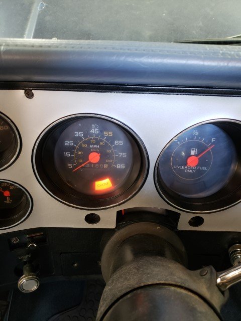

Where is the choke light at?

I will definitely have to look but I think mine says something along the lines of fasten belts.i will check in the morning,thanks

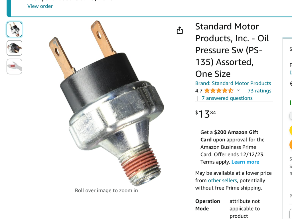

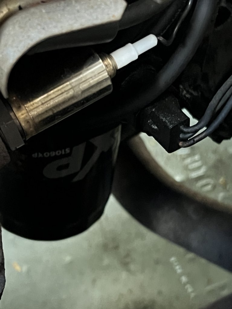

Pressure switch right above the oil filter three wire plug connected to a 2 prong switch. Mine leaks, in the process of replacing
