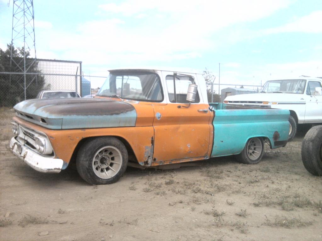

i got this truck 11 or so years ago for my kid but now tha he is 16 he has no intrest in doing the work it needed.
so i decided to drop it and make it run good and use it as a parts chaser

i dropped the rear with jeep tj coils (they drop the rear 4'' and are a bolt in thing) and 1.5'' blocks and put a 5 lug 12 bolt out of a 76.
the front has 2.5'' drop spindals and the torsion bars turned down about 2''
the spindals use the 5 lug brake rotors.
when i got the truck years ago it had sit for years with no hood and no air breather the motor is locked up solid it is a 283
until about a month ago all i had done to the truck was put a hood on it and move it around.
it was a step side i had a fleetside trailer so i swapped the beds. it made dropping the rear and axle swap easy and i like fleetsides better.
my plan is to put a 305 out of a 85 trans am i parted out in it with a 700r4 and just make it run and drive good and drive it as is.
i need to find some good fenders maybe two totally different colors i want to leave it junkyard camo just for ***** and giggles.
make it drive awsome but look like a beater even leave the general lee wheels on it.
maybe some day if i get caught up on projects do the body work and paint it.
i have a 63 that i want to get done nice before this 61
