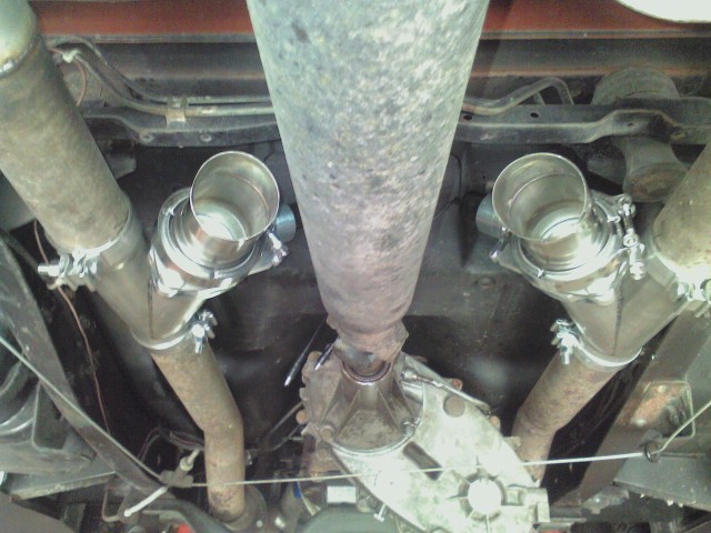

I have headers, 3" duals run out and exit behind rear wheels. This is behind big block, Thrush chambered mufflers. Nice low rumble. But if I need 'angry exhaust' I open the electric cutouts!

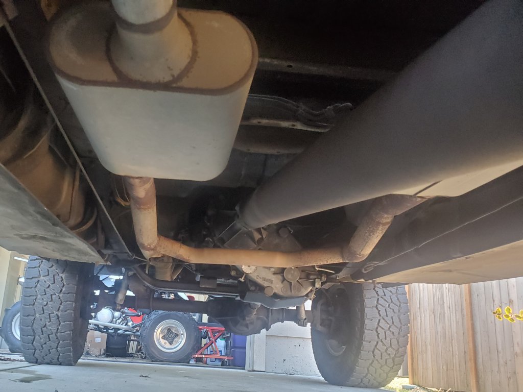

Thanks all for the great info!
I really wish I knew what the ones I have are. But I haven't been able to find any number of branding on them at all. Any ideas by a bad picture? Don't mind the kobbled together looking H pipe.
I could get a sound clip of the pickup after work if OP would like to hear what it sounds like. I swear I'm not trying to completely de-rail the thread here.

Well, they are flowmasters or knockoffs of flowmasters. Try taking a wire brush to the end caps of the mufflers. Flowmasters will have a stamped number somewhere on the end caps.
