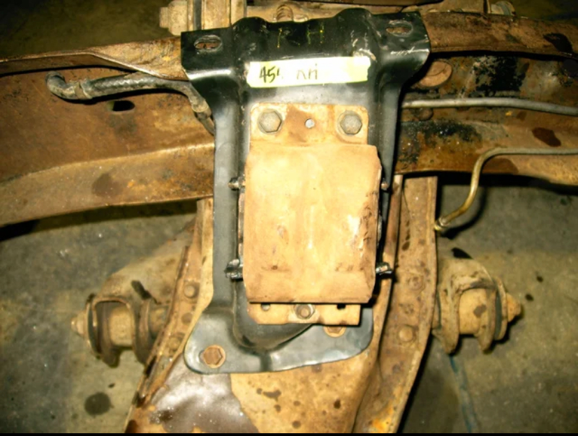

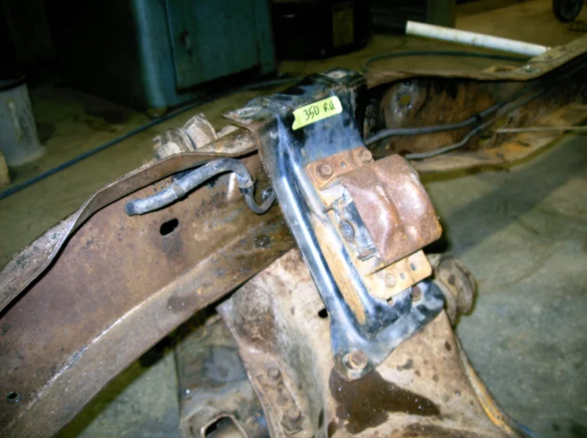

1976 C10 frame brackets are absolutely different than the ones from my donor truck 1979 C20 3+3 Camper Special. (I’ve later salvaged a 1974 C20 454, and they were the same as the 79)
As Paul Harvey would say: “And now for the rest of the story.”
I’m putting a 454 into my 1966 GMC.
That’s the frame in both pics.
Squarebody front suspension clip.
When the C10 brackets are set on the crossmember and 2 bolts inserted into the lower holes …. The bracket sits up above the frame about an inch, which would require a spacer.
When you do the same with the C20 brackets … they lay much flatter on the top of the frame rail. I did need to trim the upper edge of the frame rail about 1/4” in order to make the lay perfectly flat.
I am not the only one to experience this. 60-66 GM Truck group members on Facebook have found the same thing

I’m speaking from experience.
Even though it's a C20, the 3+3 part of it is the key here. Crew cab C20's have the same frame as a C30.
Like @DoubleDingo said, what you are doing doesn't really apply to an engine swap. You are mixing and matching frame parts.
