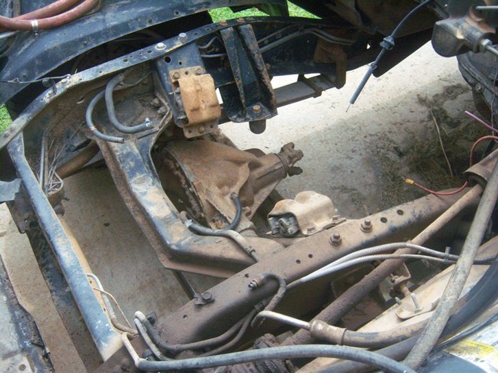

Interesting - Ford axle too, huh?
Yes, because if it were a Chevy or GMC axle it would be a right hand drop from the transfer case and the pumpkin on the passenger side. Ford and Dodge did the left side drops. GM used Dana 44's up front too up til 77 which could have been either Dana 44 or the GM Corporate 10 bolt since 77 was the transition year.
This is an 85 K10 truck with a GM Corp 10 bolt front axle. Notice the drop on the right side. Yours is on the left side. As said, probably because the engine is pushed to the right side.

Cool. The rear axle in both vans is a 14 bolt. The metallic red van that's on the trailer was more highly optioned and has a limited slip in the rear - they called it a "G80 Locking Differential"
I got that van without a motor so I haven't driven it. Not too sure about the drive train condition, but that's the van that I took the pictures of the transmission and adapters from. The fluid in the TH350 was still nice.
