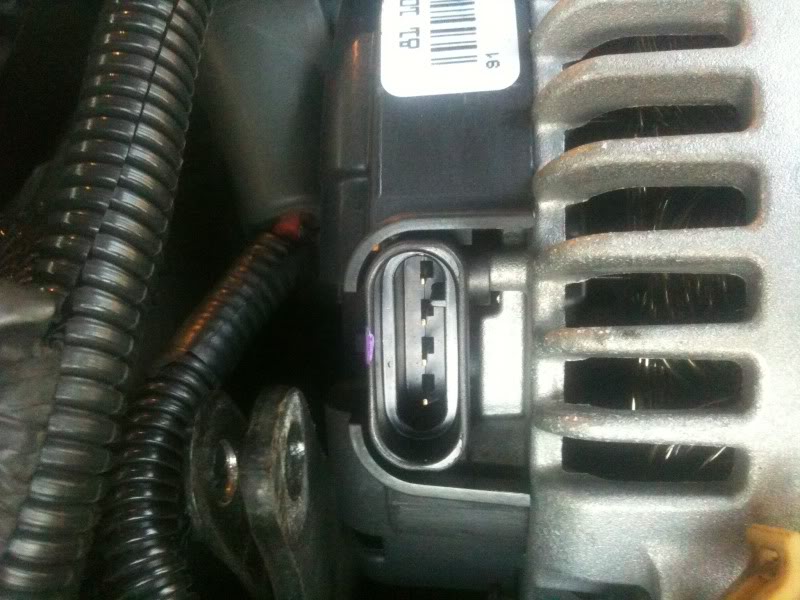

Just did a google image search and the 2 connector looks right but the 4 pin connector doesn't
Creedux
Oct 25, 2012
57
5
Canada
The 4 pin connector on my DR44 looks like this
firebane
Jul 10, 2014
1,732
30
Calgary, AB
Curtis
All newer alternators by GM use the pin plug. The older SI models used a 2 pin. If you look at the adapter you'll see its a 2 pin to 4 pin.
Creedux
Oct 25, 2012
57
5
Canada
I see the 4 pin connector but I don't think it's the right shape.
Here's a pic I found online of a DR44 plug on the back of the alternator. Hope im not making this frustrating :sorry:
31,986
32,925
The CS and DR use a different style connector. Whether or not the DR is compatible, I don't recall exactly. I think it is though, just wire in the correct two terminals.
