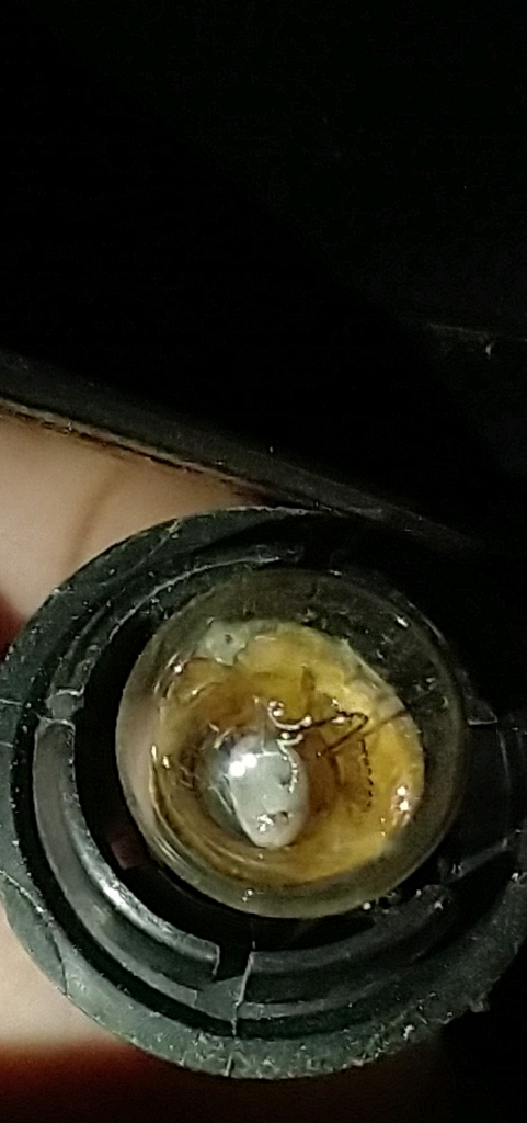

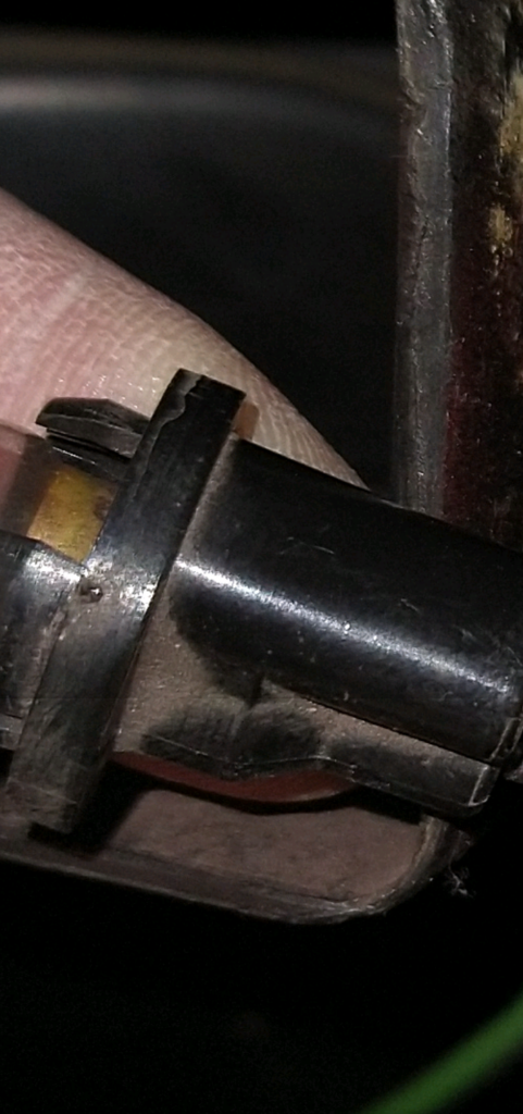

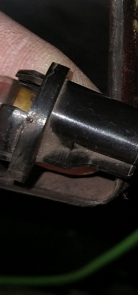

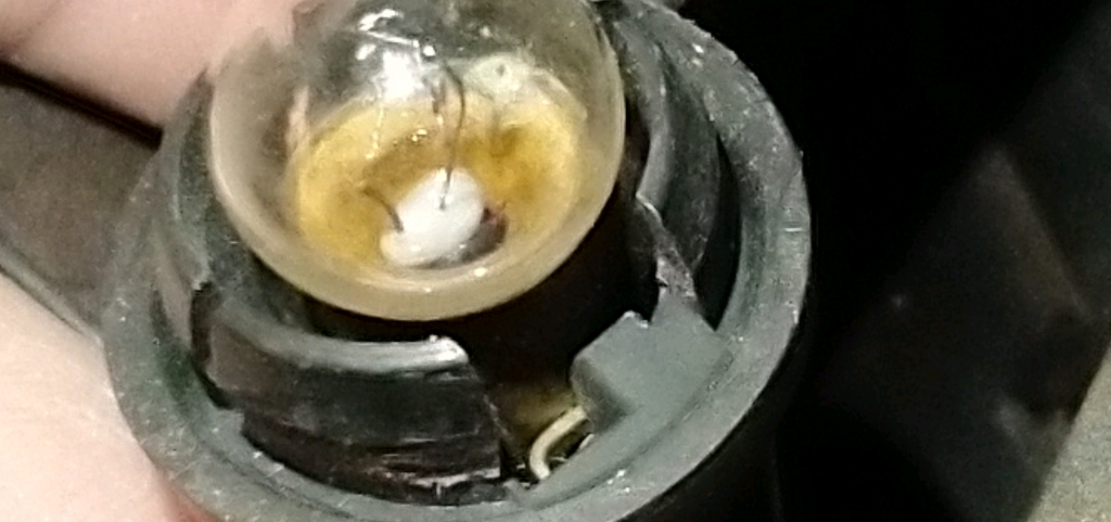

If I could find this in LED, which bulb type am I looking for? It's the climate control illumination in my 75. It's not a 194. Mini bayonet? Regular bayonet? What number? WTS..

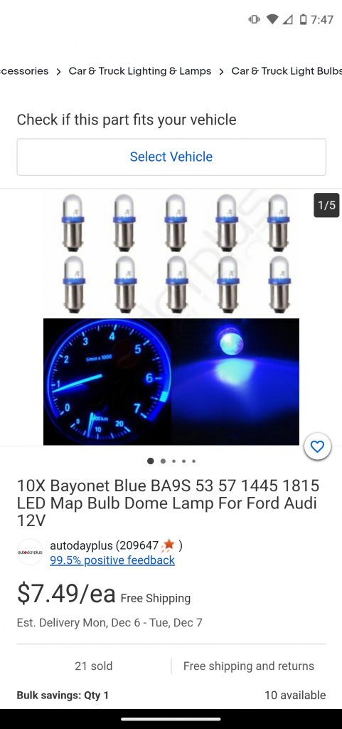

Looks like 1445, but when I look at LEDs with that number they look long

@squarelyfe,
I found a site you can go to that had a better shaped LED bulb to replace your 1445. The site is (superbrightleds.com). Sorry I couldn't show you the picture, I don't know how to do that, in this case I wish I did because others would like to see this shape as well. I'll try to brush up on my computer skills. Super Bright has their bulbs for $.98 ea. whereas another place I went to had them for $5.95 ea. Big difference. The bulbs are the same # as the ones you showed, BA9S. The 1445 were 14.4v, and 1.9w. I couldn't tell you what the LED equivalent to that wattage would be. A site was talking about 5,000 Kelvin? You got me. The BA9S were a bayonet type that will fit that socket you've got there.
