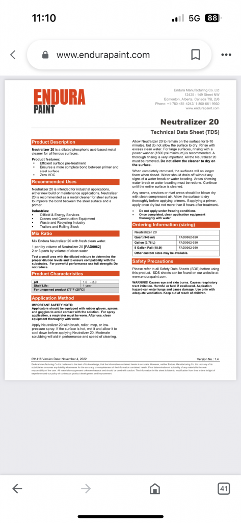

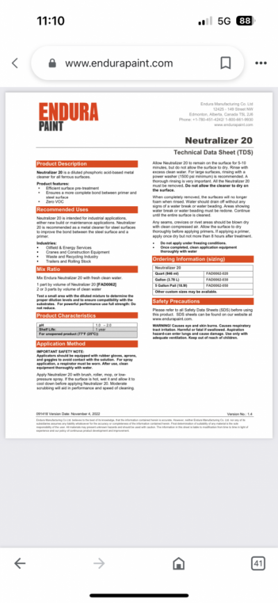

So, did a little more digging on Endura's website and found a product they make called Neutralizer 20. It is phosphoric-acid.
"Endura Neutralizer 20 is a VOC compliant formula that meets or exceeds guidelines for VOC levels. Endura Neutralizer 20 is a diluted phosphoric-acid metal cleaner for all ferrous surfaces."

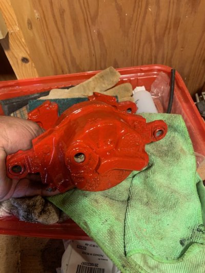

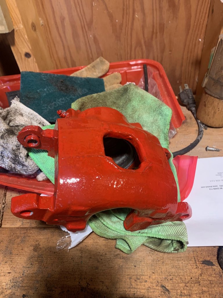

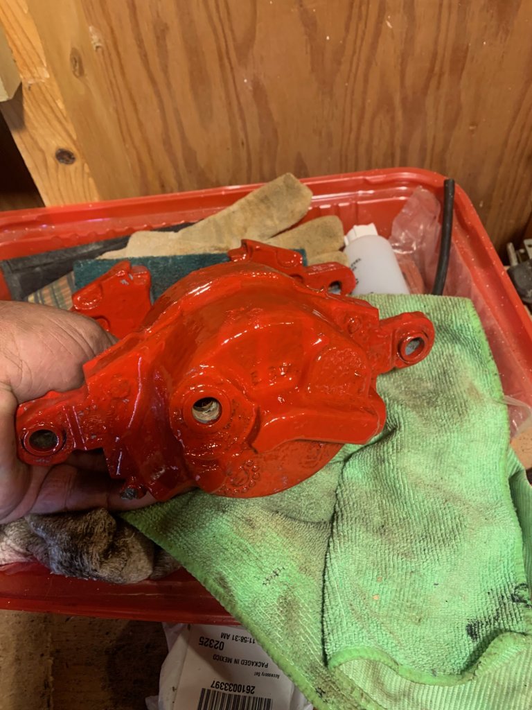

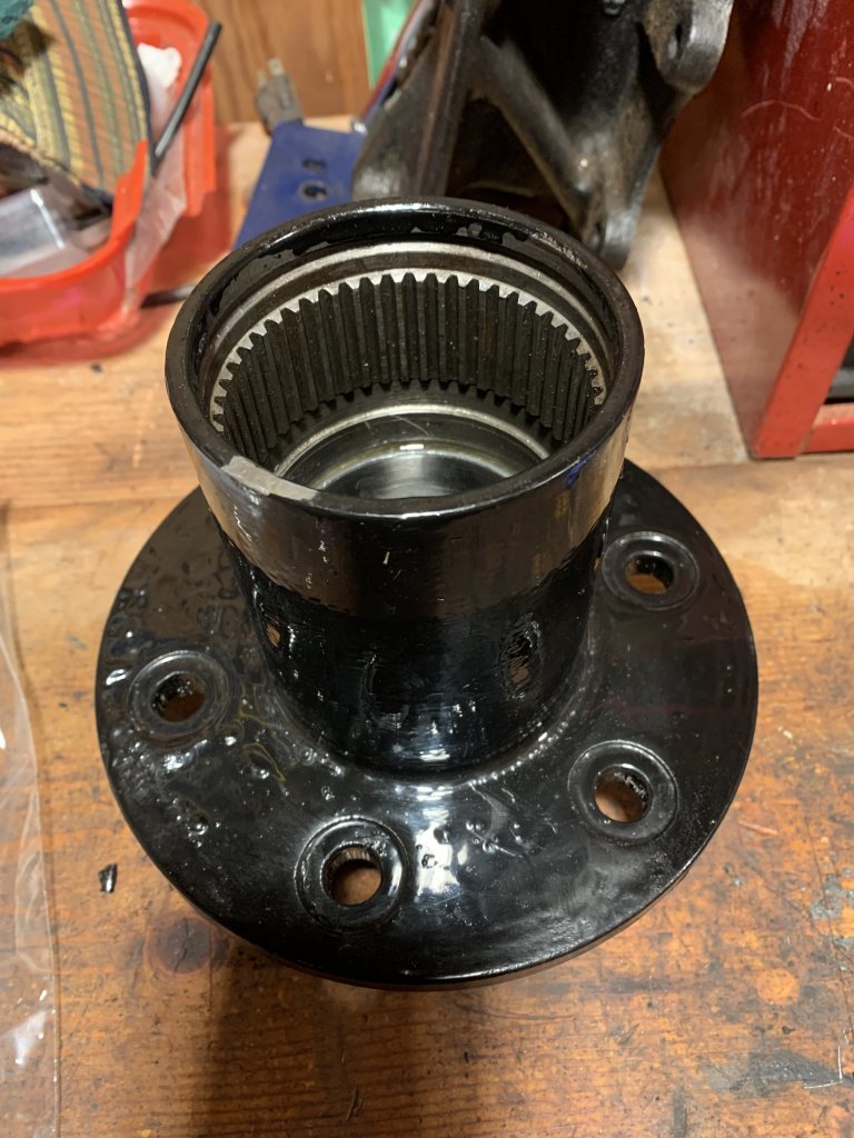

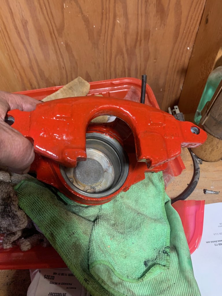

I had my frame blasted and realized after the fact I needed to do some work on it so I didn't coat it with anything. Now I'm ready to prime and paint. A few areas have surface rust from water splash marks, a one area that got something dripped on it. I wire wheeled all the spots off but I can still see the rust stain. My neighbor gave me some Por-15 metal prep to clean it up. I was thinking I would just do the whole frame with it as it has sat in the shop for a bit of time. Wondering if anyone knows if Por-15 metal prep (zinc phosphate) is only to be used with their coatings or is it ok to use with other products? Has anyone tried? I will be priming and painting with Endura which is epoxy urethane. Can't seem to find any info on either manufactures websites.
I've used por15 many times. The process they want to use is a bit awkward and time consuming. First their degreaser which they insist must be rinsed with water, then their zinc. Now the zinc needs to stay wet on the item being painted for 20 minutes! Try keeping a large part wet that long. You become a babysitter and cant do anything else. The paint they use goes on thin and can get lines in it if you aren't careful. It self levels which is good for flat items but not porous bumpy items like a break caliper. The paint is hard as all heck and cannot be taken off easily. I tried to remove the red caliper paint with acid and even that didn't get it. Lastly the caliper paint goes on thin and runny. It drips and is a pain in the butt to do. So, id suggest something else one can just paint on after the surface is cleaned. Unless you wish to do your frame in 2 foot sections...por15 is just a pain in the ass. Oh...it loves to bubble as well......

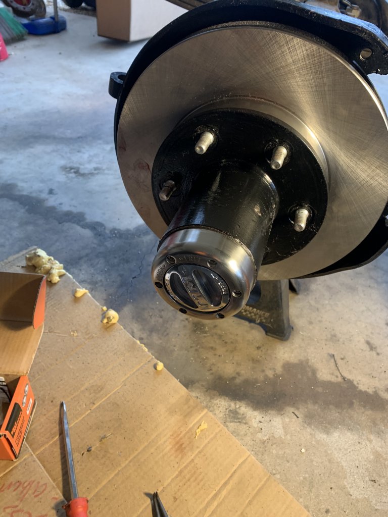

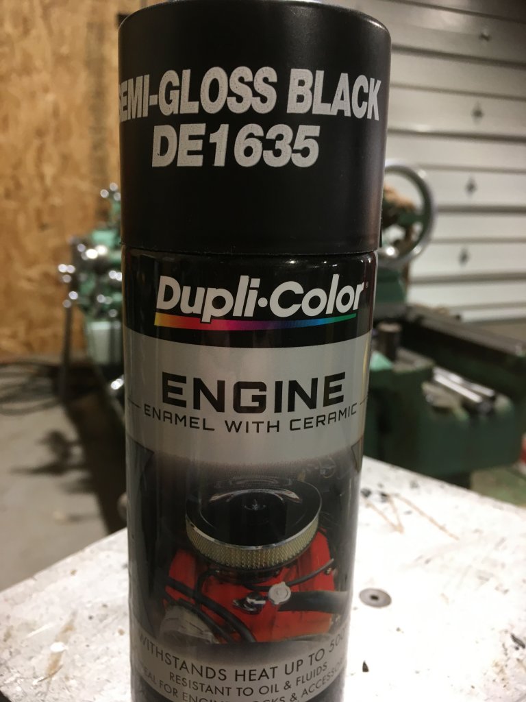

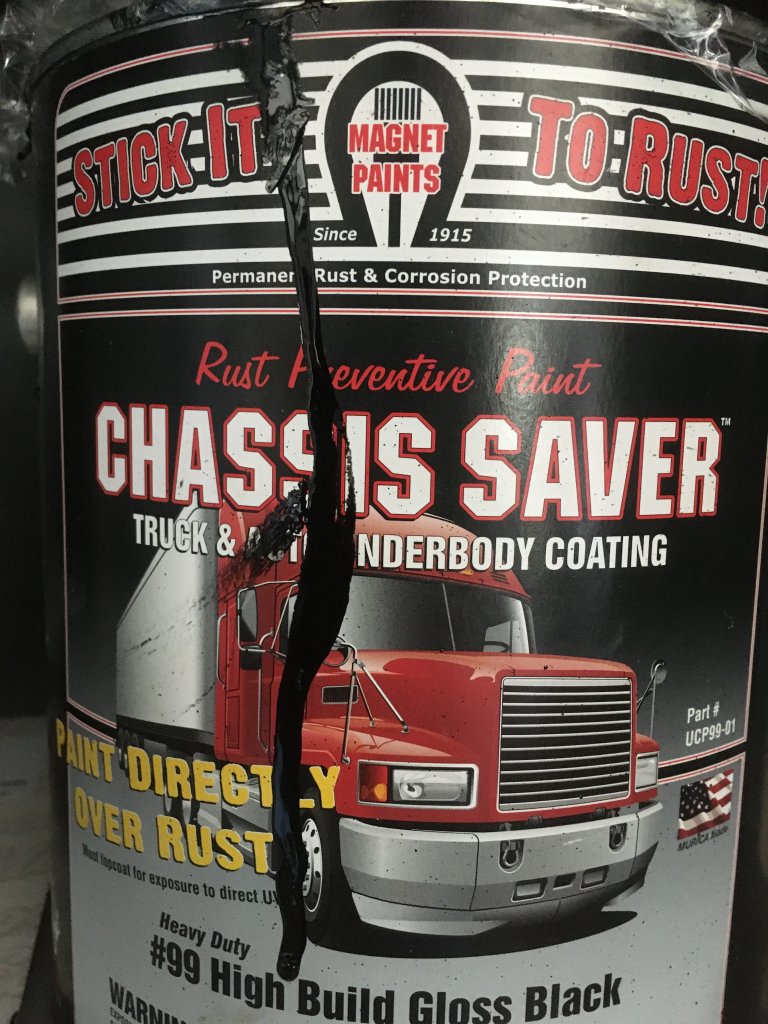

What I have been using, Chassis Saver is great stiff, had it on the drive train a few years, and still shiny and new looking. Rust converter B-4 paint. Craig Hursh turned me on to the Dupli-Color, he did his frame. It is durable, easy to apply.
