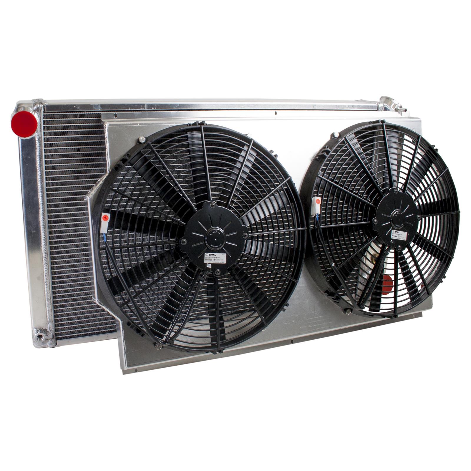

Welcome from Austria. Nice Truck and good work. Where did you buy the grey radiator mounts?
Thanks for the warm welcome, everyone.
The spacer blocks are kind of an experiment. I designed them in OnShape and printed them out on my Ender 3.
There are upper and lower pieces that I painted to match my color scheme.
I finished them up with some rubber rad mount material I found on Summit.
https://www.summitracing.com/parts/SUM-380666
I'm installing this radiator, and the blocks fit it really well.
I'm using PLA printed with stock specs. I won't be surprised if they fail. I'm only trying to find out how so I can improve them. Stay tuned for more on that, I guess lol.
I can send you the design if you want to print some for yourself.
