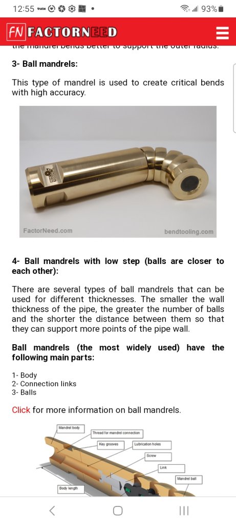

Sorry, but I zeroed in on tailpipes and strings of ball bearings…not sure why though.
Here's what goes in the pipe before bending, the machine pulls it through to keep the inside of the bend uniform. Similiar to packing the pipe with sand,but better.

I don't have access to a exhaust tubing bender anymore. Do any of you? I never tried,just this thread made me think of it ,pack a piece of exhaust tubing with wet/damp sand tape both ends shut with duct tape bend it see if it bends more smoothly,more like mandrel and let us know.
