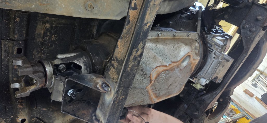

Today me and my buddy got the 4L80e in. It was easy as can be. Worst part was I had to cut away more at the gutter so the blower lid could sit deeper so the driveline angle was correct.
I was able to use the original 4.3 cross member, and cut the platform off and welded it on the backside.
Ill use the c10s old 1350 yoke on the output as well.
I dont like that cheesy trans mount ,OR the single point of contact and will be definitely getting something better for the long haul because I intend on making my motor mounts solid as well.
Its enough to get the project off the ground though. THAT is a 2500 HD 2wd trans mount LOL
Im fixing to go to Chicago for a week, when I get back ill work on it some more.
