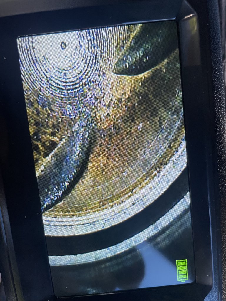

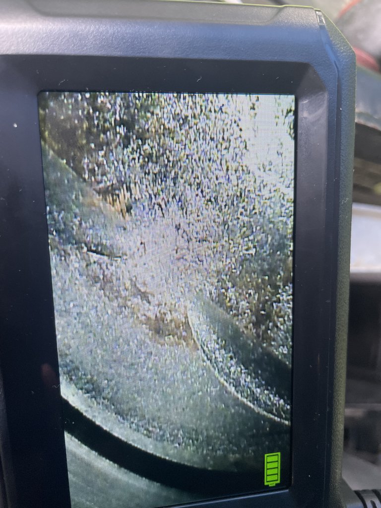

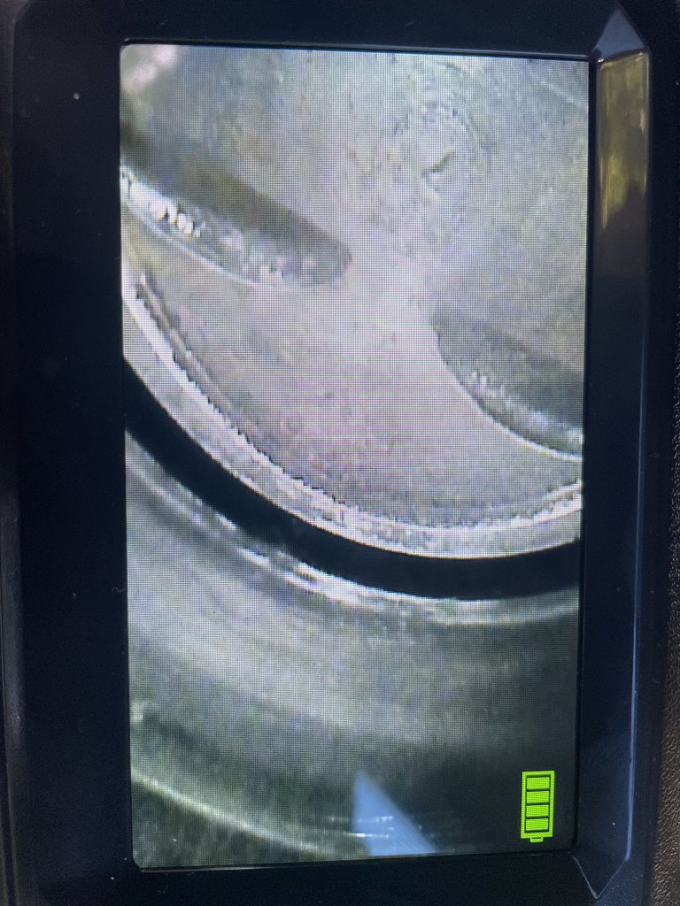

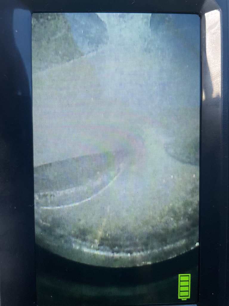

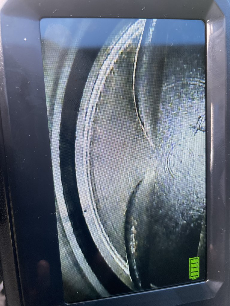

Alright, been few days since I could work on truck, in the meantime I ordered one of those cheapo borescopes that I got off the intraweb. $35.
So , looked at it today and and took some pictures. If I can figure out how to post them, I will. Hard to get a shot of the entire piston head in one shot , ,but I didn’t see any pooling of coolant and couldnt find any running down cylinder walls. But some look wettish in the center, some look really clean. Any thoughts ?
