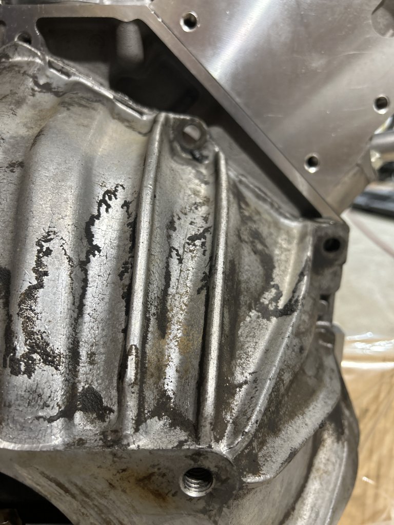

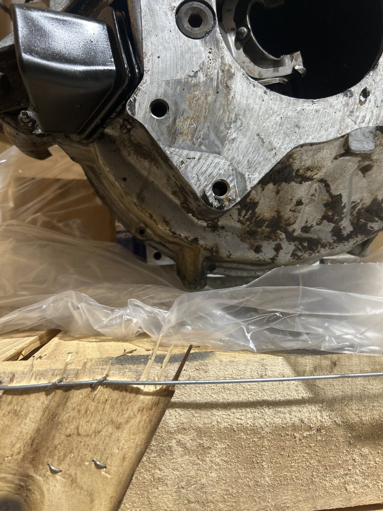

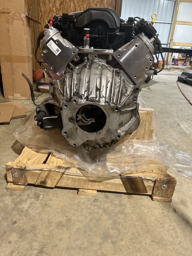

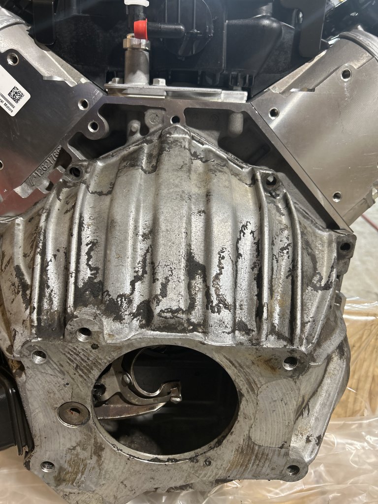

I am swapping a ls3 into an 85' chevy k20 suburban w/ muncie465 manual 4sp and for the most part the bell housing bolts line up but not all such as the 12 o'clock position does it matter if they dont all get used?

Thanks squaredeal91 I think there’s a couple other two to be exact that don’t particularly lineup or even have a spot for them

These are the ones I’m curious on

How many holes actually lign up? 3?

Five of the six holes on the bell housing lineup with the engine

Looks like you might be able to fabricate a holding bracket using that top hole. Can probably carefully flatten a spit in the bell housing and press it to the block to keep it from vibrating and flexing.

Yeah thanks I could probably have somebody aluminum shop weld something on the top as well
