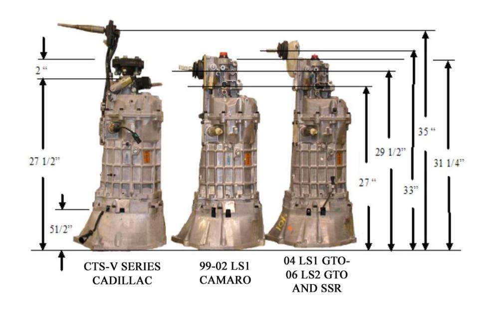

Anyone in here do one? Im THINKING about swapping in my built 6L and run a T56 since my 87 is already a 3 speed manual. What I would really like to know (see pics) where the shifter ends up. I do NOT want to go with bucket seats. I want to keep my original, beat, ripped up seat.

theres 2 shifter locations on a t-56, theirs the tailshaft mount, then theres a Place in the actually trans case to relocate it to. Also you could get an offset shifter plate to move the arm attachment forward, then get an S arm shifter to wrap it up around the seat. By doing those 2 things, it should clear your bench.
That sounds like a plan! Now to find a T56. Man, the wife is gonna shoot me!! :gr_guns:

This may help with your question. I remember seeing this when someone was trying to swap an LS2/T56 into an RX8.

I have an 87 swb and I am in the middle of my project it's a Iron block built 5.7 ls motor with T56 tranny the shifter is around 10" or so farther back I was going buckets so I never mocked up my bench but I'm pretty sure it won't work without modifying something
