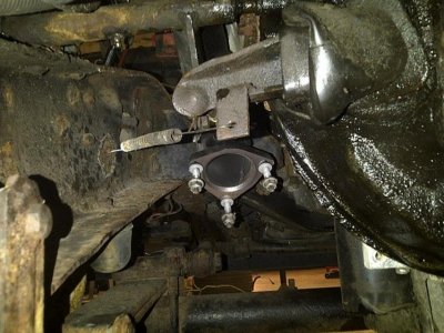

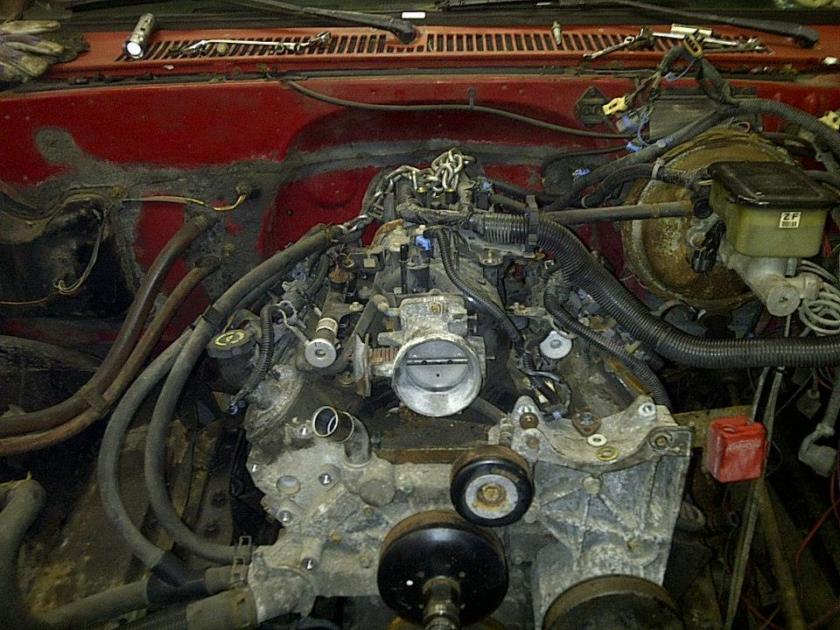

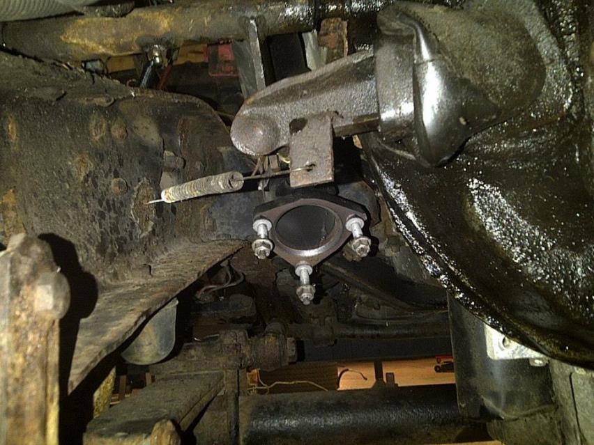

bump old thread with a few pics
84 K20 5.3/sm465
