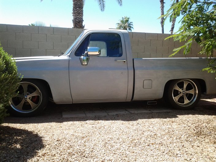

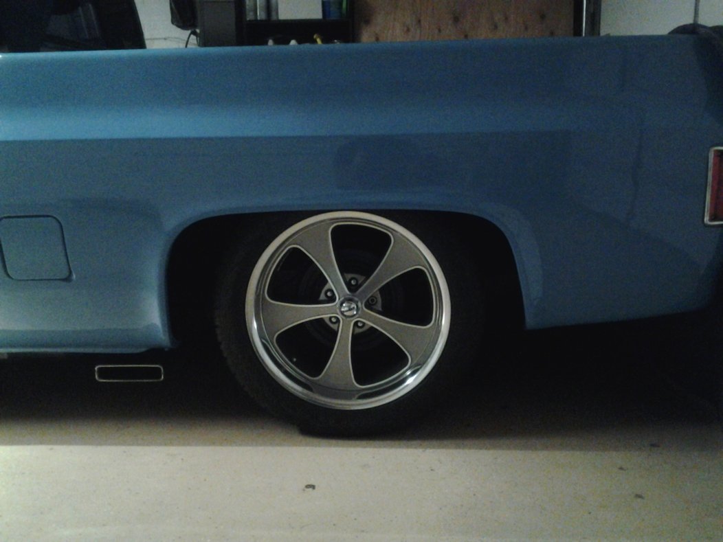

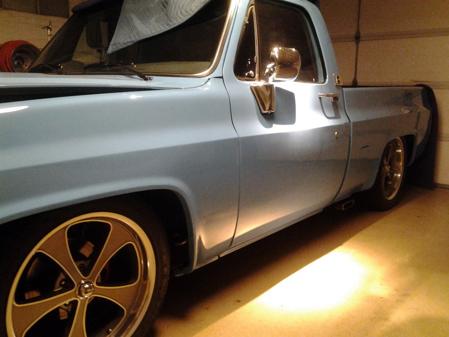

1) 2 " or less drop spindle if you want to keep the 15" rims and not need to shave down the lower control arms. If you shave them down its best to weld a gusset to maintain the integrity. You could start with a drop coil (3") first. Cutting the oem springs will get the stance, but progressive drop coils will ride much better.
If you want to maintain the best ride quality, without using the tires as bumpstops, the only way to get 4-5 inches up front is to swap out the 15" wheels for a larger diameter. You will run into clearance issues up front. Dont use a grinder to make clearance. Do it right and do it safely. Looks are nothing if you end up ripping up a classic truck in the process by hacking components.
As far as the rear, buying a flip kit is the easiest way to go instead of fabbing your own. They are turnkey and in a few hours can be installed easily. You can fabricate lower shock mount extensions easily as well. I made a pair of my own in a few hours out of steel stock. If you like, I can post pics of them.
My 84 -87 square has a 5front and 7 rear drop. No modifications were needed to the driveshaft. I did remove and fab my own front fenderwells. I also ditched the 15" rallys for 20x8 fronts and 20x10 rears so that I could tuck the wheels prior to my 4 link and bag setup. I plan on bagging the truck by next season.
